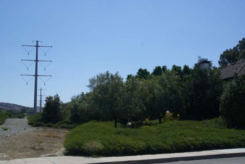

They are 200 feet tall. Not for the spreading to homes but to transport to substations. The towers are larger than anything I've ever seen or have been able to find.
I read the wiki on a few related subjects. Its unusual for them to be so close to homes. But something has to be done to mitigate their effects on property values, which happens to cover any harmful effects to people since nearby harmful things generally destroy property values.
It does seem that having such heavy duty power lines nearby can possibly cause health issues related to EMF, but that's not relevant at this point since the comission has ordered consideration of an option that preliminary studies priced at more than $200 million more expensive than finishing the overhead lines. Anything that's cheaper than $125 million that negates the problems of noise, appearance, and safety should be preferable.
So those lines need 3.5-4 meters of distance away from anything flammable or anything in general?

Personally, I think we should be burying our power lines. They'd use less land and be more reliable due to lack of issues with trees.
Be careful with the abbreviation EMF (Electro Motive Force). This is used for a source of power and is not the same as Electro Magnetic radiation, like light or radio waves.
Radiation in the form of Electro Magnetic Radiation is extremely small at 50 Hz or 60 Hz because of the very low frequency. Most of the power stays in the wire.There is a magnetic field around any wire that carries a current and power lines are no different.
However, as I mentioned, the magnetic fields tend to cancel each other out at ground level because the currents are flowing in different directions, so the fields have opposite polarities.
This also applies to the electric voltage gradient due to the voltage from the wires to the ground.
Yes, the wires of a transmission line do dissipate heat, but they are very well ventillated and are not allowed to get hot enough to damage themselves by melting the conductors.
Because of the very high voltages used for long distance transmission lines, only a small percentage of the total power is lost due to heat in the wires.
