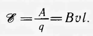

Good afternoon! The low voltage in the Faraday disc is not related to the use of rings or brushes. The rings and brushes provide quite good electrical contact. The low voltage in the Faraday disk is explained by the principle of its operation. In such a generator, it is impossible to apply a winding and increase the voltage due to ampere turns. This is due to the fact that the electric field that appears when the disk rotates is electrostatic. For an electrostatic field, the integral of the closed-loop voltage is zero. The EMF during disk rotation is determined by the equation:
Thus, it is possible to increase the voltage in such a generator in the following ways:: 1) increase the speed, 2) increase the magnetic induction, 3) increase the length of the conductor (disc radius). As the disc radius increases, its speed on the outer brush increases, which leads to increased wear. To eliminate wear, liquid conductors are used.
If a high voltage source is connected in series to a rotating Faraday disk, a very large current will flow in the circuit, almost a short circuit. The fact is that the Faraday disc has a very low internal resistance. In addition, this connection will switch the generator to electric motor mode. The disk will start rotating in the opposite direction, overcoming the force of the primary motor (or simply stop if it does not overcome it).
When the disk rotates in generator mode, load current flows through it. An Ampere force acts on this current, which tends to stop the disk. If the load current is amplified by an external current, the Ampere force will exceed the force of the primary motor and the disk will either stop or start rotating in the opposite direction. In any case, the disk will stop generating and nothing will be added to the external voltage and current.
