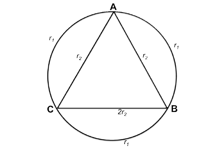

In summary, the attempted solution states that the current will flow from A to B then c, but the voltmeter readings will be different depending on where the voltmeter is located.

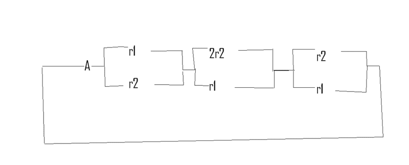

A circular coil with radius a is connected with an equilateral triangle on the inside as shown in the figure below. The resistance for each section of the wire is labeled. A uniform magnetic field B(t) is pointing into the paper, perpendicular to the plane of the coil. B(t) is decreasing over time at a constant rate k. Given 2r1 = 3r2. Find UAB, the potential difference between points A and B
3. The Attempt at a Solution
i transformed the given circular circuit into such
is it correct starting from point a i went a loop around the circuit clockwise by lenz law
i reasoned it as the magnetic field is decreasing through all part of the circle no matter which loop or triangle i pick the current must flow in clockwise hence i came up with this
is there any thing wrong with my reasoning[/B]

The induced electric fields are non-conservative. The line integral of E.dl from A to B along the circumference will not be same as the line integral along the triangle's side AB. Plus, the reading of the voltemeter will depend on how you connect the voltmeter between A and B. So I don't think your transformation of the circuit is valid. (Layout of the circuit is important here.)

very sorry i meant 2R1 = 3R2

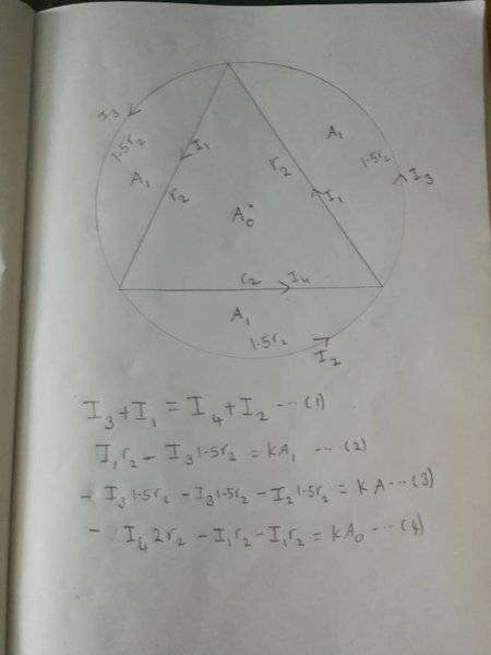

@vishnu 73 , I think a good approach to the problem is to label the currents in each of the six branches in the circuit. There are three branches for the triangle and three branches for the circle. You'll need to set up six equations for the six unknown currents; say, 4 loop equations and 2 junction equations.
For any loop, you can set up dΦ/dt = Σ(±IR) where the sum is over the branches in the loop. The signs depend on your choice of current directions.
Once you set up the equations, you can use some sort of software to solve the six equations.
By symmetry, two of the triangle branches will have the same current and two of the circular arcs will have the same current. This can be used to reduce the number of unknowns. I did not use this symmetry. Instead, I let the software solve the six equations and then checked to see if the particular currents were equal.
I think the problem statement is unclear on what they actually want. If you go from A to B along the leg of the triangle you will get a different IR drop than if you go from A to B along the upper right circular arc. This was already pointed out by @cnh1995 in post #2.
The IR drop for the leg of the triangle is the same as ∫Edl along the leg of the triangle. Similarly for the the circular arc.

Is this correct? Does the direction of the current I assume matter? there is one loop I haven't used then there would 5 equations for 4 unknown making it overdetermined and lastly what sign should I use for the change in magnetic field thanks for the help
vishnu 73 said:
Is this correct?
Yes, all four equations look correct. I assume that ##A## in equation (3) is the total area of the circular loop.
No. Pick any direction, the sign of your answer will tell you if you picked the actual direction.
Right.
The flux is into the page and decreasing. So, what should be the "direction" of the induced emf in any loop (clockwise or counterclockwise)?
Looks like your equations correspond to the correct direction of the induced emf's.

@vishnu 73, your equations look correct to me. You can solve them simultaneously, get the six currents and find the line integral along path AB (and all other paths if you wish). That would be the " net emf" along side AB, which is not same when you choose different paths to go from A to B. What remains same is the "electrostatic potential difference" between A and B or VAB.
Net emf is the resultant of electromagnetically induced emf and electrostatic potential difference.
So, for side AB, you know the net emf and electromagnetically induced emf. Find VAB from that (take care of the polarity). I believe this is what the question in your OP is asking.
  • #33
@cnh1995 i am confused once again
1)what is net emf my guess is that if there was one and only equilateral triangle ABC then the net emf along AB is the k(area)/3 is that right
but in this case there is many more paths which have AB as one of their sides hence the sum of all such emf is the net emf along AB is that what net emf is
2)then no what is electrostatic potential difference prior to this problem my understanding is that electrostatic potential difference is just the difference in potential between two point
i am all confused with the terms again what is difference between net emf , electrostatic potential difference and how does that relate to Vab

@TSny
i am getting these are these correct
I_1 = \frac{k(6A_1 - 1.5A_0 - 2A)}{12r_2}\\
I_3 = \frac{k(6A_1 + 1.5 A_o + 2A)}{-18r_2}
