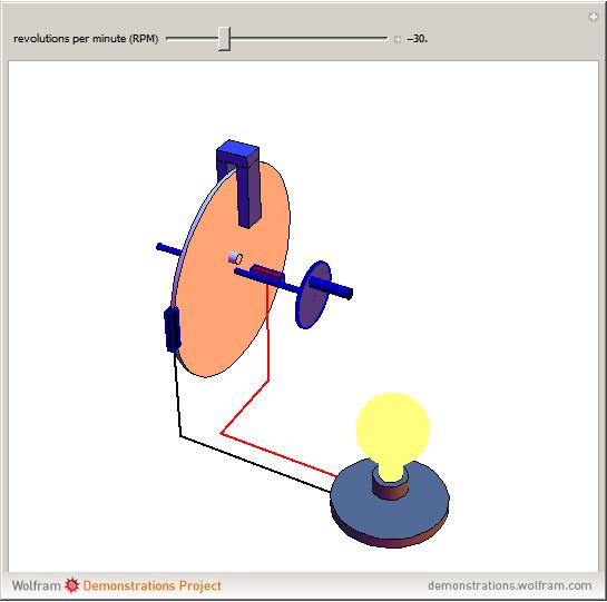

There is a homopolar generator on a train moving at 215 km/h. The magnet of the generator is attached to the disk so they would rotate together, but they are stationary now, except that they are moving along with the train. Is there any current generated by the generator?
I expect the answer will be "no", so next I ask what is the difference between the disk and the magnet rotating together, and them moving together along in a train?
Consider the motion of electrons relatively to the magnetic field in both cases.

I am missing something here. In a homopolar generator the disk and the magnet do not rotate together; the disk rotates in the static magnetic field produced by fixed magnet, right?
Yes, I was puzzled too. I thought maybe he means if the disk and magnet rotate together, there is still a current. If this is true, then I think it is because at a slow speed, the magnet can just be treated as producing a rotating magnetic field, but because of the rotational symmetry, the magnetic field seen by the disk is the same as if the magnet were not rotating. So all that matters if that the disk rotates relative to an inertial frame (about the axis of symmetry of the magnet)

There are three combinations and two paradoxes:
1.) disk rotates, magnet stationary -> induced current
2.) magnet rotates, disk stationary -> no current (paradox 1)
3.) disk and magnet rotate together -> induced current (paradox 2)

We are talking about the case where the magnet is fixed to the disk and rotates together with it. Surely magnetic field of the magnet will not separate from its source but will always be at the same location relative to the magnet and at the same location relative to every point on the disk.
As you said, the magnetic field is a vector field, an arrow at every point in space. Treat the magnet as the source of the field, as you say, and rotate the disk by a a fixed angle about its axis. Will the arrows in space change, given the symmetry of the magnetic source about the axis of rotation?

The magnet in a hompolar generator does not rotate around any of its axis but around an axis that is outside of the magnet. When rotated the magnet's path describes a circle just like it would if it was stationary on a train which goes around the Earth. There is also no any waiting in operation of homopolar generator.

The tricky part of a homopolar generator is understanding the current density. It is not obvious.
As was mentioned by vanhees71 back in post 6, there is no possibility of a paradox here. This is simply an example of a hidden complexity which makes rigorous analysis complicated.
Ad #28: Then I misunderstood your question in #1. Perhaps you have a drawing of the setup somewhere?
I thought, you mean the usual setup, where a wheel is rotating in an external magnetic field or by rotating the magnet itself. The latter was the one I discussed.
The current in this case is due to the rotation of the magnet not by a current due to an external battery. Perhaps I shouldn't have called it "Hall effect". It's just the rearrangement of charges due to the force on the electrons from the electromagnetic field. In the stationary state this force must be 0.
We are talking about the 3rd case where the magnet is fixed to the disk and rotates together with it. Imagine slapping a magnet on the rim of your bicycle wheel, that's all there is to it.
