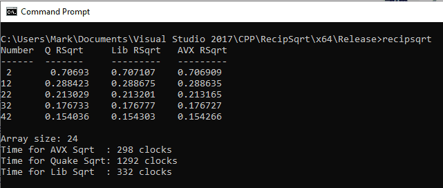

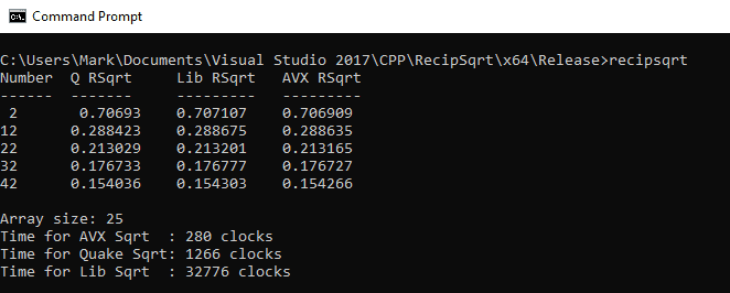

Here's a screen shot of a run with an array of 25 floats:
The output shows selected values from the array. As you can see, the AVX version outperforms the Quake algorithm, running about 4.5 times as fast, and is nearly 120 times as fast as the version that uses the standard library sqrt() function. Again, what you're seeing is the release version, compiled with optimization set to highest speed.
But, and this really puzzles me, if the array size is a multiple of 8, we get significantly different results in times for the Quake and standard library versions.
Notice that the standard library version is significantly faster than the Quake version, and is only slightly slower than the AVX version. I've noticed this discrepancy in quite a few tests -- if the array has a multiple of 8 elements, the library version speeds up dramatically. At the moment I have no idea why this happens.
Wouldn't it be fun to have a debugger that could step through in sufficient detail to see the bits change, and see the memory & cache accesses.
Depending on your code it may be VS' auto-vectorization optimization that kicks in. You should be able to test if this is the case by including a pragma mentioned below and see if the times go up again.
From https://docs.microsoft.com/en-us/cpp/parallel/auto-parallelization-and-auto-vectorization :
The Auto-Vectorizer analyzes loops in your code, and uses the vector registers and instructions on the target computer to execute them, if it can. This can improve the performance of your code. The compiler targets the SSE2, AVX, and AVX2 instructions in Intel or AMD processors, or the NEON instructions on ARM processors, according to the /arch switch.
The Auto-Vectorizer may generate different instructions than specified by the /arch switch. These instructions are guarded by a runtime check to make sure that code still runs correctly. For example, when you compile /arch:SSE2, SSE4.2 instructions may be emitted. A runtime check verifies that SSE4.2 is available on the target processor and jumps to a non-SSE4.2 version of the loop if the processor does not support those instructions.
By default, the Auto-Vectorizer is enabled. If you want to compare the performance of your code under vectorization, you can use #pragma loop(no_vector) to disable vectorization of any given loop.
My debugger won't show individual bits, but I can see if memory or variables change values. Can't see cache accesses, though.
I'm going to guess that this is exactly what happens. I'll look into this further.
@Filip Larsen, apparently what happens is that, if the array size is a multiple of 8, vectorization occurs. That means that SIMD (single instruction multiple data) instructions can be used, with either 128-bit or 256-bit registers holding four or eight floats in a register, and a single operation being performed on the contents.
The exact sequence I see in my debugger is the following:
C:
movups      xmm0,xmmword ptr [rbp+rcx+50h]
movaps      xmm2,xmm3
sqrtps      xmm1,xmm0
divps       xmm2,xmm1
movups      xmmword ptr [rbp+rcx-20h],xmm2
Without going into too much detail, (1) the values to have square roots taken are copied from memory to XMM0, (2) four copies of 1.0 are copied to XMM2, (3) the values in XMM0 have square roots taken and stored in XMM1, (4) the reciprocals are found using the divps instruction and placed in XMM2, and finally, (5) the values in XMM2 are stored to memory.
OTOH, if the array size is not a multiple of 8, the compiler does not generate the SIMD instructions for the square root and division, but instead calls the standard library sqrt() function. The situation is probably similar if the array size is a multiple of 4.
I didn't try the pragma you mentioned, but I would be very surprised if using it does not alter the times for array sizes that are multiples of 8 or even 4.
