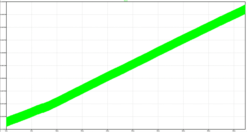

So I implemented the duty cycle calculation and it works somewhat ok. Unfortunately, if I add actual models it will start to have more deviation since there will be more losses, but I guess it's as good as I can get for now. In case anyone is interested, I used...
.param D=sqrt((Vo**2-Vo*Vi)*K)/(Vi**2))
where all of the necessary parameters were also defined by .param statements.
Here's the output after ~55 ms with the output set to 9.64 V with a .ic statement. Setting it to 9.65 V the voltage starts to slowly drop overtime so the steady state is 9.64-9.65 V. The comanded voltage is 10 V so it is really close.
A closed loop controller would be ideal, but hey this gets the job done.

If you want to perform this operation, you must first tell the simulator how to determine whether the converter should work in CCM mode or DCM mode based on input parameters. In other words, you must provide the simulator with the boundary condition equation between CCM and DCM. Then, you need to create two different duty cycle signal sources, one for CCM and the other for DCM, and let the simulator choose which signal source should be used to perform the simulation.
Of course, another method is to try to design a simple feedback controller. In any case, sooner or later you will have to face this challenging design process. :smile:

It's really hard to simulate SMPS with feedback controls since the time scales are so different. Sort of by definition, or maybe good design, the time scale for feedback loops is really slow compared to the time scale required to simulate the fast (cycle by cycle) operation. As a really crude approximation: if you are switching at 100KHz then your simulator will need at least 1usec steps (probably much faster, actually). Yet the bandwidth of the feedback controls would be something like 1Khz with perhaps a 350usec response time. So, for you to see your feedback working, you'll have to look at something like 40-100 switching cycles. This is where state-space averaging is useful, to replace the high frequency behavior with an averaged model that is accurate at low frequencies.
In my experience, simulators are best for the very fast stuff, like what happens in 1 or 2 switching cycles, or slow stuff, like the control system. I always used analysis on paper to solve the in between time periods. I think you need to be really clear on what data you need to get from the simulator, and don't waste effort on things that you can solve in other ways. I think there is a huge difference between simulating a circuit and understanding a circuit.
Still, I like LTSpice, and those guys certainly know about SMPS design, so I would look to see if they have any support (app notes, or simulations) for their boost converter designs. It may not be the same as your design, but they may have good examples about how to simulate that stuff that you can then modify.
I've found some controller designs that I've been able to modify to work for my circuits, like CCM buck and boost converters, in LTspice and it definitely slows down the computation. I usually end up having to change the minimum timestep to something like 1 usec (as you suggested) or even 0.1 usec for it to converge. I've found that changing the integration method or adding small parasitics can help it converge quicker in some cases. I agree though, state space modeling is quicker when possible. Unfortunately, this is just the front end of the circuit and finding the state space model is quite a bit more complicated. After I get this part figured out, will likely use Matllab/Simulink for the controller design. The simulations are MUCH quicker (seconds compared to several several minutes possibly) and they seem to have simple design toolboxes.
