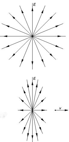

And that looks different than this screen-shot, February 2018, of the Feynman lectures.
Is there some reason that the Lorentz transformation cancels out the total energy multiplication factor? Or is this just a typo in the online transcription of Feynman's book?

As Feynman points out in his explanation below 26.11, the relativistic effect (speed approaching c - ie. v approaching 1) is a reduction in the magnitude of the electric field in the x direction.

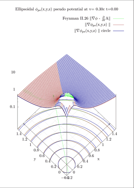

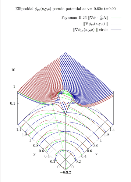

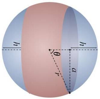

I know from trying to guess a potential energy function that would give the right E field, that the potential is roughly ellipsoidal. All I know how to do is take a numerical gradient of a guess function and compare that to the E fields of Feynman. Using errors, I can attempt to improve my guess by inspection. I simply don't know how to solve the calculus, but I'm working on it. The math is still ... complicated.
I've plotted my work so far as a clear example. I'm plotting equal force contours instead of force lines (gnuplot's smart enough to do it, but not force lines.) Since force magnitude is supposed to drop off as one over square radius in any direction, I am plotting against a normalized [itex]1/r^2[/itex] with equal changes in r. That makes the spacing of the |E| contours will uniform on each plotted axii but to different scales. The elliptical nature of the contours is easy to spot. They don't cross x and y at the same radii. There is hardly any difference between Feynman's exact |E| surfaces (curved green lines) compared to my brown potential's gradient contours even at v=0.3c.
Note: The straight green line is separate asymptote. That's where Feynman's green |E| plot intersects with a reference non-moving particle's |E| field (blue circles). So the green line represents a place where the moving charge's gradient has the same magnitude as a non moving charge with same origin. The fact that such an intersection exists and is never at the halfway point between x and y-axis is very interesting. [itex] m = { \Delta y \over \Delta x } = +-\sqrt { {1-(1-v^2)^{2/3}} \over {(1-v^2)^{1/3} -1 } } [/itex]
On all axii, my approximation exactly converges to Feynman's solution for all values of v. But, for really fast particles, say v=0.6c, there is significant error when not near the x,y,or z axis. See second plot.

Error correction: I got a sign flipped in the power of the computation of the slope.
It should be:
[itex]m= \sqrt { { 1-(1-v^2)^{-2/3}} \over {1-v^2}^{1/3} } [/itex]
Also, since y and z axii are equivalent; this asymptote rotates in three dimensional space to create a "cone" that opens in x.
So, there are three volumetric regions in a unit sphere divided up by this cone. There are two spherical caps, and a band down the center (like a striped billiards/pool ball where r is defined by the slope from origin along either y or z).
Note, [itex] \lim_{v \to 0 } m = \sqrt {2} [/itex] eg: it's not 1.
So, for very tiny velocities mm/year ... the asymptote and cone is still not symeterically dividing up space. The volume of the two spherical caps and cone is not 50% of the total spherical volume around the charged particle. Nor is the surface area of the two caps 50% of the total surface area of the spreading force field's spherical surface.
Light energy spreads out with square law (surface area) diminishing. Light is similar to a certain amount of 'substance' stretching out on the surface of a spherical balloon as it expands in space. I supposed, originally, that the potential energy generating a force field ought to behave approximately the same way.
However, the force field (and hence potential energy) even for extremely slowly moving objects does not spread out equally in the direction of motion vs. perpendicular to that direction. There is a strong asymmetry in how it spreads out no matter how small the motion. This was very surprising to me.
