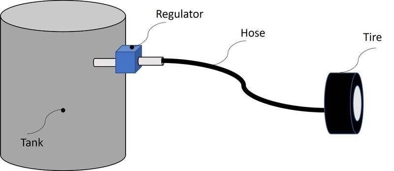

This thought came to me while I was trying to fill my MTB bike tire a while ago as an exercise in laziness to not "check" the tire pressure with a separate gauge! Mostly, my mind just wanders...
If I have some very large tank filled with compressed air at gauge pressure Ptank. The hose runs to an idealized PRV which regulates the pressure down to Preg and holds it constant. At the other end of the hose is connected to rigid tire of volume V−tire, and initial pressure Patm (0 gauge).
How long will it take until the pressure in the tire reaches the regulated pressure ## P_{tire} = P_{reg}?
I'm just starting with Newtons Second, and analyzing from the hose to the tire and I'm already in uncharted territory:

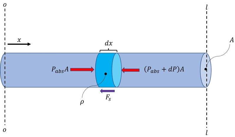

My first go was this assuming that the temperature of the flow remains constant:
$$ F_P−F_{P+dP}−F_s=A dx\frac{d}{dt} \left( \rho v \right) $$
$$ \left( P + P_{atm} \right) A - \left( P + P_{atm} + dP \right) - \tau_o \pi D dx = A dx \left( \frac{d \rho}{dt}v + \rho \frac{dv}{dt} \right) $$
Changing independent variable from time ## t ## to position along the hose ## x ##
$$ \Downarrow $$
$$ - \frac{dP}{dx} - \frac{ \tau_o \pi D}{A} = \frac{d \rho}{dx}v^2 + \rho \frac{d}{dx} \left( \frac{v^2}{2} \right) $$
The density is given from the Ideal Gas Law:
$$ \rho = \frac{P + P_{atm}}{RT} \implies \frac{d \rho}{dx} = \frac{1}{RT} \frac{dP}{dx} $$
We then have that:
$$ - \frac{dP}{dx} - \frac{ \tau_o \pi D}{A} = \frac{1}{RT} \frac{dP}{dx} v^2 + \frac{P + P_{atm}}{RT} \frac{d}{dx} \left( \frac{v^2}{2} \right) $$
Before I go any further, am I going in the right direction?

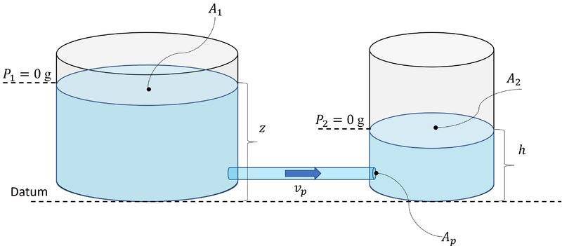

I would like to try and cast some doubt by showing that for viscous, incompressible flow between two tanks, equilibrium is archived in a finite amount of time.
For incompressible viscous flow between two points 1 & 2 we have the following result derived from Conservation of Energy applied to Reynolds Transport Theorem:
$$ \frac{P_1}{\gamma} + z + \frac{v_1^2}{2g} = \frac{P_2}{\gamma} + h + \frac{v_2^2}{2g} + \sum_{1 \to 2 } h_L \tag{1} $$
For the system above we have that:
## v_1 = \dot z ##
## v_2 = \dot h ##
## P_1 = P_2 = 0 \rm{gauge} ##
## \sum_{1 \to 2 } h_L = k \frac{v_p^2}{2g} ##
Plugging that into (1):
$$ z + \frac{ \dot z^2}{2g} = h + \frac{ \dot h^2}{2g} + k \frac{v_p^2}{2g} \tag{2}$$
Next, put everything in (2) in terms of ##h## the height of the liquid surface in tank 2
Since the flow is incompressible the total volume of the system must be preserved:
$$ A_1 z + A_2 h + {V\llap{-}}_p = V\llap{-} \implies z = \frac{1}{A_1} \left( V\llap{-} - {V\llap{-}}_p - A_2 h \right) \tag{3} $$
Furthermore, by taking the derivative of (3) with respect to time ##t##:
$$ \dot z = - \frac{A_2}{A_1} \dot h \tag{4} $$
By continuity we also have that:
$$ A_p v_p = A_2 \dot h \implies v_p = \frac{A_2}{A_p} \dot h \tag{5} $$
Substituting back into (2):
$$ \frac{1}{A_1} \left( V\llap{-} - {V\llap{-}}_p - A_2 h \right) + \left( \frac{A_2}{A_1} \right)^2 \frac{ \dot h^2}{2g} = h + \frac{ \dot h^2}{2g} + k \left( \frac{A_2}{A_p} \right)^2 \frac{\dot h^2}{2g} \tag{6} $$
Rearranging (6) and combining constants we end up with a first order ODE of the form:
$$ \dot h = \beta \sqrt{ \lambda - \varphi h } \tag{7}$$
Where:
## \beta = \sqrt{ \frac{2g}{ 1 + k \left( \frac{A_2}{A_p} \right)^2 - \left( \frac{A_2}{A_1} \right)^2 } } ##
## \lambda = \frac{1}{A_1} \left( V\llap{-} - {V\llap{-}}_p \right) ##
and
## \varphi = 1 + \frac{A_2}{A_1} ##
Now, the steady state height of fluid in tank 2 can be found by setting eq (7) ## \dot h = 0 ##
$$ h_{ss} = \frac{\lambda}{ \varphi} $$
From (3) it follows that:
$$ z = \lambda - \left( 1 - \varphi \right)h $$
$$ z_{ss} = \lambda - \left( 1 - \varphi \right) \frac{\lambda}{ \varphi} = \frac{\lambda}{ \varphi} \implies z_{ss} = h_{ss} $$
Now, all that is left to do is show that equilibrium must be reached in a finite time by solving (7) by method of separation of variables:
$$ \int \frac{dh}{ \sqrt{ \lambda - \varphi h } } = \beta \int dt $$
Performing the integration:
$$ - \frac{2}{\varphi} \left( \sqrt{ \lambda - \varphi h} - \sqrt{ \lambda - \varphi h_o} \right) = \beta t \tag{8} $$
If we substitute ## h = h_{ss} = \frac{\lambda}{ \varphi} ## into (8) we are left with:
$$ t = \frac{2}{ \varphi \beta} \sqrt{ \lambda - \varphi h_o} \tag{9} $$
From this analysis it is apparent that the heights of the fluid in each tank are equivalent after a finite amount of time has passed.
Now, what ( if anything) about compressible flow destroys the "finite" result?
$$ \dot Q - \dot W_s = \frac{d}{dt}\int_{cv} \left( \frac{V^2}{2} + gz + u \right) \rho \, dV\llap{-} + \int_{cs} \left( \frac{V^2}{2} + gz + h \right) \rho \, \boldsymbol V \cdot d \boldsymbol A \tag{10} $$
Ok, I think I've figured out something. The flow is not steady (it varies in time) ,and that was a simplifying assumption of (10) that leads to (1).
Taking the straight section of pipe joining the tanks as the control volume:
## \dot Q = 0 ## Net rate of heat transfer entering
## \dot W_s = 0 ## Shaft work
$$ 0= \frac{d}{dt}\int_{cv} \left( \frac{V^2}{2} + gz + u \right) \rho \, dV\llap{-} + \int_{cs} \left( \frac{V^2}{2} + gz + h \right) \rho \, \boldsymbol V \cdot d \boldsymbol A $$
So examining the first term on the left, I realized this is where I went wrong:
$$ \frac{d}{dt}\int_{cv} \left( \frac{V^2}{2} + gz + u \right) \rho \, dV\llap{-}$$
The flow is assumed incompressible, there is no change in elevation and the internal energy I'm not quite sure how to precisely handle at the moment. Its going to be a function of the temperature gradient ( which I expect to be small for the tanks problem) so I'm assuming that whatever it is, its rate of change in time is very small and can be neglected.
$$ \frac{d}{dt}\int_{cv} \left( \frac{V^2}{2} \right) \rho \, dV\llap{-} + \cancel{ \frac{d}{dt}\int_{cv} \left( gz \right) \rho \, dV\llap{-} } + \cancel{ \frac{d}{dt}\int_{cv} \left( u \right) \rho \, dV\llap{-} } = \frac{d}{dt}\int_{cv} \left( \frac{V^2}{2} \right) \rho \, dV\llap{-}$$
With incompressible flow ## V^2 ## can come outside of the integral, and the term reduces to:
$$ \frac{d}{dt}\int_{cv} \left( \frac{V^2}{2} \right) \rho \, dV\llap{-} = \rho { V\llap{-} }_{cv} \frac{d}{dt} \left( \frac{V^2}{2}\right) $$
For the second term in (10), nothing really changes:
The properties are assumed to be uniformly distributed across the control surfaces ( subscripts o and i refer to the outlet and inlet ) and we have that:
$$ \int_{cs} \left( \frac{V^2}{2} + gz + h \right) \rho \, \boldsymbol V \cdot d \boldsymbol A = \dot m \left[ \left( \frac{V_o^2}{2} + gz_o + h_o \right) - \left( \frac{V_i^2}{2} + gz_i + h_i \right) \right] $$
with no change in elevation, or cross sectional area of the pipe:
$$ \int_{cs} \left( \frac{V^2}{2} + gz + h \right) \rho \, \boldsymbol V \cdot d \boldsymbol A = \dot m \left( h_o - h_i \right) $$
So I believe I am left with the ODE:
$$ \begin{eqnarray} m_{cv} \frac{d}{dt} \left( \frac{V^2}{2}\right) &= \dot m \left( h_o - h_i \right) \tag*{} \\ \quad \tag{11} \\ m_{cv} V \frac{dV}{dt} &= -\rho A V \left( h_o - h_i \right) \tag*{} \end{eqnarray} $$
And I think its by the Second Law ( viscous flow ) that the quantity ## h_o - h_i > 0 ## and we say that its change it is proportional to ## \frac{V^2}{2g} ##
So that leaves me with:
$$ \frac{dV}{dt} = -\alpha V^2 \tag{12} $$
Where ##\alpha## is just a constant
This has the solution:
$$ t = \frac{1}{\alpha} \left( \frac{1}{V} - \frac{1}{V_o} \right) \tag{13} $$
and as ## V \to 0 ##, ## t \to \infty ##
Is that what you had in mind for the type of solution?

Initially I got the problem wrong because my equation (1) in post #15 was not applicable. @Baluncore and @bob012345 thought that equilibrium should only ever be approached via oscillation, exponential decay, or some combination of both. After I looked more carefully at the equation from which (1) was derived, Eq (10) in post #20, I saw my error. (1) assumes steady flow, and the flow in the pipe connecting the two tanks is changing in time (unsteady).
So I whittled (10) down to (13) for the velocity of the flow in the pipe as a function of time, which does have the behavior that they propose that as ## V \to 0, t \to \infty## . However, in doing so I invoked what I though was a consequence of the Second Law for the change in enthalpy across the pipe as well as some other simplifying assumptions about the internal energy earlier:
but I'm not sure that is legitimate?
For the original tire problem, what exactly does the regulator do? Does it just maintain a constant pressure at its end of the hose like a boundary condition? Does it input gas from the tank to do so? If so then doesn't there have to be a source term in the differential equation?
bob012345 said:
What exactly does the regulator do? Does it just maintain a constant pressure at its end of the hose like a boundary condition? Does it input gas from the tank to do so? If so then doesn't there have to be a source term in the differential equation?
It's just an idealization of a device that regulates the pressure to be constant ( a boundary condition ), so I don't have to consider the change in pressure of the source. It doesn't need to be there, other than to describe the application, and how this system attempts to function in "real life". We could just replace it with an very large supply tank at the desired pressure.

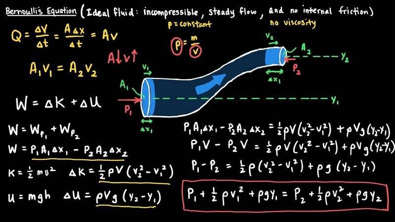

If you want an idealization you should use an ideal fluid. I cannot follow what you did in post #15. I don't know where you get the last term on the RHS and what is ##\gamma##. I think the Bernoulli equation in the connecting pipe would suffice here .
## \gamma = \rho g ##
Divide your pink box equation through by ## \gamma ## and add the viscous effects and you are at (1) in post 15

It appears you interpreted v1=z˙ ect. so you have two fat pipes facing downward but ignore the connecting pipe. I don't know if that is valid? I suggest you ignore viscous effects for the ideal case first. Also, focus on the connecting pipe.
  • #31
I ignore the viscous effects in the tanks, because they tanks are assumed to be large, and the kinetic head is going to be very small compared the kinetic head in the pipe. Thus very small viscous losses in the tanks. The head loss in the connecting pipe is what is considered significant with ## v_p##.
If you want the "Bernoulli Solution", take ## k ## to be zero in post 15. The only factor that contains ##k## is ##\beta##.
The entire effect of the pipe disappears ( because there are none), The solution that follows remains fundamentally unchanged by ignoring viscous effects as ## \beta ## is just a constant.
