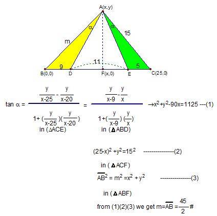

$\triangle ABC,$ point D and point E are on segment BC
given:
(1)AC=15, BD=9, DE=11, EC=5
(2)$\angle BAD=\angle CAE$
Please find AB=?
