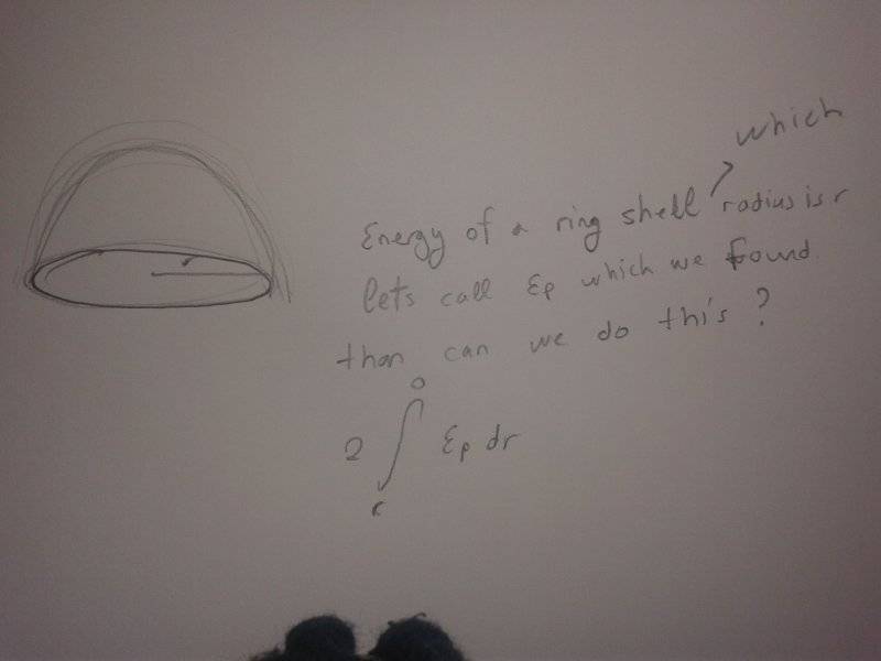

Is this true

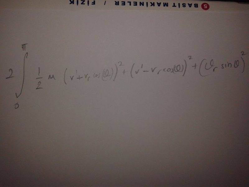

Ok,now

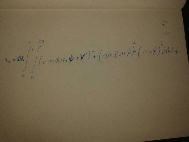

Here again

Quarlep said:
Ok,now
Yes, that's good, but you don't need to do an integral at all this way. When you expand the terms, all references to theta should disappear, so all the terms are constants.

I find a stupid answer m((v')^2+r^2+2( π)^2
  • #69
I had trouble reading your attachment at post #65. In view of what you say now, I studied it again, and it looks like you have r where I would expect to see v.

Quarlep said:
Ok yeah yeah you are right.Is that all thing somy equatipn is true If I change r to v ?
There are some more errors. The m at the front should be ##\rho r^2##, where ##\rho## is the density. There should be a factor ##\sin(\theta)## inside the integral (or maybe it's ##\sin(\theta)##, whichever goes from 0 to ##\pi##). This comes from the polar expression for an area element.
  • #72
ρr2((v')2+v^2+2π^2)+ integral sinθ from 0 to π
  • #73
Better, but that 2π^2 term shouldn't be there. Previously, every term had a factor of either v or v', so that should remain true. Instead, I would expect to see a factor π throughout. Please post all your steps.

Hi I see your post but I couldn't answer cause I am in holiday now and here time is 07:20 am. In this post you said ##\sin(\theta)## will be inside the integral but theta goes 0 to pi so here I am confused and I ll going to write pr^2 instead of m ?
  • #77
In your integrand you have trig functions of phi and theta. But you must have put the area element as ##m d\theta d\phi##. The area element should have been ##\rho r^2 \sin(\theta)d\theta\phi##. After simplifying the rest of the integrand, you still have one term left that has trig functions in it. You must multiply the sin from the element with this before integrating it.
This will be a lot easier to explain if you post all your steps as typed equations. Please stop posting images of working, they're too hard to read and too hard to make comments about.
