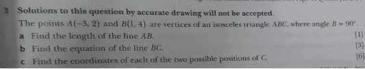

Find the question here; My interest is on question ##3(c)## only.
My approach, Let the co ordinates of ##C##= ##(x,y)## then considering points ##B## and ##C##. We shall have the gradient given by;
##\dfrac {y-4}{x-1}##=##-2##
also from straight line equation, considering points ##A## and ##C##, we shall have;
##(x+3)^2+(y-2)^2=40##
we know that, ##y=-2x+6## from the given equations above, then we shall have,
##(x+3)^2+(-2x+6-2)^2=40##
##(x+3)^2+(-2x+4)^2=40##
##5x^2-10x-15=0##
##x^2-2x-3=0##
therefore possible co ordinates of ##C## are ##(3,0)## and ##(-1,8)##
I am seeking a much simpler approach...of course i assume the reader is conversant with my approach...because of time i cannot show step by step...but shout out to me if an equation is not clear. Bingo! :cool:heeey!
Simpler approach:
To get from A to B we add 4 to x and 2 to y.
The segment from B to C is perpendicular to AB and the same length, so it must have absolute values of changes in x and y reversed, ie 2 and 4, and those changes must have opposite signs.
Hence, adding those changes to the coordinates of B = (1,4), we see it will be
(1 + 2, 4 - 4) = (3, 0)
OR
(1 - 2, 4 + 4) = (-1, 8)
andrewkirk said:
Simpler approach:
OR
Thanks, I had initially thought of this approach and found it ambiguous ...correct though...
