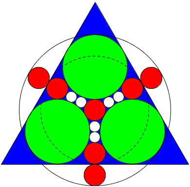

I like Serena said:
For the record, something like that is called a sangaku.
Doesn't sangaku simply literally means triangle, though?
Nope Mr.Fly:
Sangaku translation: calculation tablet) are Japanese geometrical problems or theorems on wooden tablets which were placed as offerings at Shinto shrines or Buddhist temples during the Edo period by members of all social classes
Google translates triangle as sankakkei.
And searching for sankakkei shows that this word is also used for a three dimensional puzzle of triangles.
However, that is different from a sangaku.
