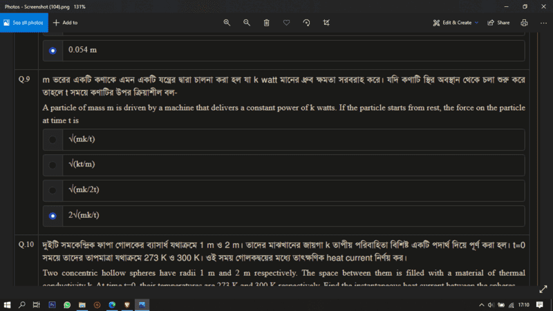

A particle of mass ##m## is driven by a machine that delivers a constant power of k watt. If the particle starts from rest, the force on the particle at time t is...................
##\vec F=m\frac{d^2 \vec s}{dt^2}##
##P=\frac{W}{t}##
##W=\vec F\cdot \vec s##
My attempt :
##\frac{\vec Ft^2}{2}=m\vec s##
##s=\frac{Ft^2}{2m}##
##P=\frac{W}{t}##
##k=\frac{\vec F\cdot \vec s}{t}##
##k=\frac{F^2t^2}{2mt}##
##k=\frac{F^2t}{2m}##
##F=\sqrt{\frac{2mk}{t}}##
But there was an option which was ##2\sqrt{\frac{mk}{t}}##. And my assumption was that it was correct. They approximately equal but not completely. Do you get the same answer? Or do you get ##2## outside the square root?
