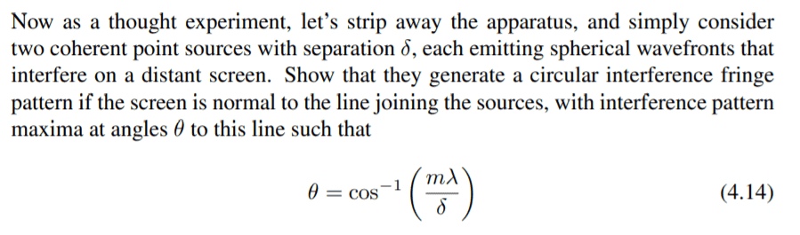

See attached file. (m=0,2,4,6,...)

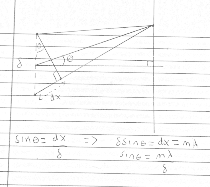

dsin(theta)=m(lambda)

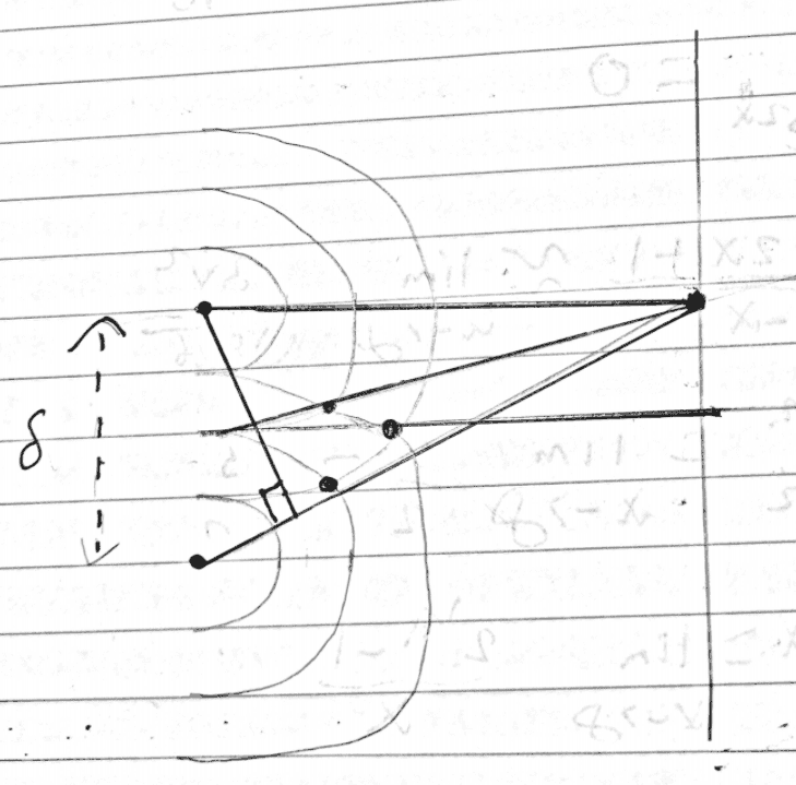

I drew a diagram in the attached files as well, but the the scenario seems to be the same as the double slit experiment, but I don't understand why the answer contains cos instead of sin.

Where are the sources in you sketches ?
And the line joining the sources ?
If the screen is normal to the line joining the sources, where is the screen ?

Read the original question carefully. You should see that θ is the angle with respect to the line joining the sources, so the angle you've marked as θ is in fact 90º – θ.
(It's more conventional to define θ in the way you interpreted it, but they've done it differently in this question.)
Oh! Thanks so much I completely missed that.
And did you find a
circular interference fringe pattern
on this screen ? Can you make that explicit ?
