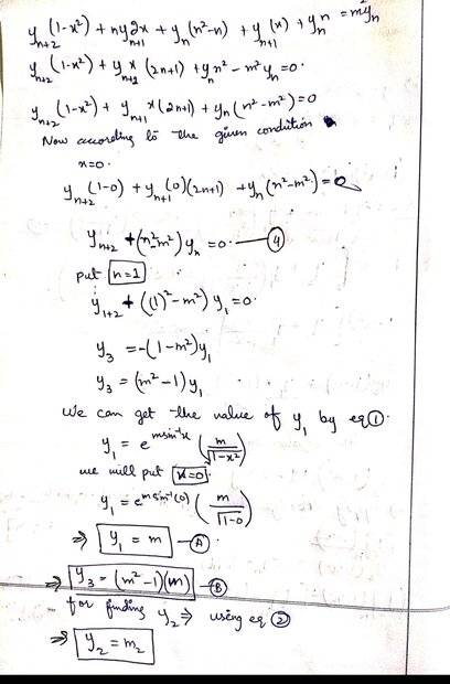

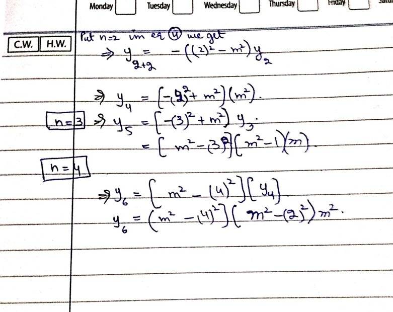

Here is the problem that I'm trying to solve. I've done the first part that is prove but I'm. facing difficulty in finding nth derivative
I'm attaching pics of my attempt of solving this problem as I've no idea that how to type all these mathematical expressions.
Can anyone please guide me that how to find the nth derivative (it always confuses me )
I will be thankful for your guidance.

So there ! But you had already done that, witness the pictures :

Let me pick up at your
##A## is correct, but ##B## seems to be in error. I leave it to you to find the minus sign in your picture ....
:smile:

It looks like you have the basic idea. Just keep writing terms and look for the pattern (if it isn't apparent from what you've done already).
View attachment 325221##A## is correct, but ##B## seems to be in error. I leave it to you to find the minus sign in your picture ....
:smile:
Thanks a lot for your guidance😊
So, B = −(1−m^2) (m)
In that(which I've done)
I write equation ##B## down as :
−(1−m^2) = (m^2−1)
It means that I've multipled the whole bracket with this negative sign. Am I picking the right point?

That means that ##y^{(2n)} |_{x=0}## comes into the picture too. Good thing I had fun deriving $$
y^{(2n)} |_{x=0} =\prod_{k=0}^n \left( (2k-1)^2+m^2\right )$$so almost the same expression -- but I am at a loss trying to merge the two into a single one..... help !
Kumail Haider said:
Probably B = −(1−m^2 )(m)
Am I write know?

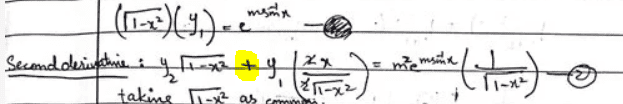

I think it's going wrong here already:
That should be a minus sign, which turns your 3 into my ##(2) ## and then it agrees with
Likes Kumail Haider
Thanks🙂
I think I get the point. I was making mistake in taking derivative of √(1−x ²) it should be −2x /2√(1−x ²)
Is this the mistake that I was making?
Indeed...
Likes Kumail Haider
