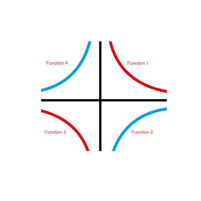

I would like to deepen the problem in this way:
Let's suppose we need to add a further constraint in this method. The constraint is that the functions should be as much opposite to X axis as possible between each other.
For example if we consider 4 functions (instead of 30) in the subgroup, one ideal combination is this one:
In this case, as you can see:
1. Total Area = 0 [positive area - negative Area = 0]
2. Function 1 is opposite to Function 2 and Function 3 is opposite to Function 4.
Then there is a perfect match between the 4 functions!
I would like something similar to that (not necessary a perfect opposition!). Just to be clear, if we have group of two functions; the positive maximum of the first function should correspond to the negative minimum of the second function and so on!
I was thinking to split the domain in more parts and perform a check in the single domains, but maybe this is a massive operation.
Do you have any suggestion?

What's the bigger context of this problem? I think what you're asking is going to increase the complexity of the problem a great deal, because now you have a lot more areas to calculate in advance. You'd have to something like define the $i,j$ area:
$$A_{ij}=\int_{x\,\in\,\mathcal{D}(f_i)\cap\mathcal{D}(f_j)}[f_i(x)-f_j(x)]\,dx,$$
so instead of three hundred areas, you now have $44700$ areas to compute! (You can divide the $300\times 300$ by two because $A_{ij}=-A_{ji}$, and then subtract $300$ because $A_{ii}=0$.) Maybe that's ok, but that's a lot of computation. You could re-cast your cost function like this:
$$C=\sum_{\text{groups}}\;\sum_{\begin{array}{c}f_i,\, f_j\;\in\;\text{group}\\ i<j\end{array}}A_{ij}^2.$$
I'm moving the square inside, because we don't want one of the $A_{ij}$ to cancel with another one. Another option is to define
$$A_{ij}=\int_{x\,\in\,\mathcal{D}(f_i)\cap\mathcal{D}(f_j)}[f_i(x)-f_j(x)]^2\,dx,$$
and then not bother squaring in the cost function. This approach will more closely line up your functions across the $x$ axis, but it will be more computationally expensive, as I've pointed out.
