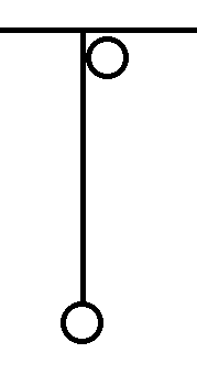

@inigooo, Can I chip in. The question says:
“A secondary ball with the same weight as the first ball is ... just touching the cord” [my underlining]​
The wording in the question is (IMO) poor. I guess it should also say that the two balls have the same radius. So the centre of the upper ball is above the edge of the lower ball.
A good diagram is needed showing the positions of the balls at the moment of impact.
I suggest stepping-back a bit; revise/read-up how to solve simple ‘oblique collision’ problems. There is plenty of help available, e.g. a YouTube search for “elastic oblique collision in two dimensions” gives a number of videos. The first video I got (which is not necessarily the best) was:
EDIT: Can I add this, on edit. I'm not saying that the impact is a simple oblique collision because the presence of the (presumably inextensible) chord is a major constraint. However, considering the line-of-centres and the tangent plane between the balls - as we would for a simple oblique collision - is important.
  • #43
Something like this:
Because if the balls have to be treated as pointmasses, one have to assume something regarding the chord.
Likes Delta2

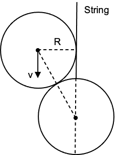

Why point masses?
Here is the diagram at the time of the collision assuming that the balls have the same radius ##R##. It seems to me that the momentum of the two-ball system is not conserved in the vertical direction because the string constrains part of the system from moving in that direction. Assuming that there is no friction while the balls are in contact, the top ball delivers an impulse directed along the center-to-center direction which can be calculated from the geometry.
Likes Steve4Physics and Delta2

so that it effectively becomes a 1-d problem. But then one has to assume something about the chord.
  • #46
If this were a 1-d problem, then why ask for the direction of the velocity in part (b)?
I'm not sure the problem is fully defined. There are in effect two impacts, one between the balls, which we are told is elastic, but one also in the sudden tensioning of the string. We can assume the string is inextensible but is it elastic or fully inelastic?
Edit: in the case of an elastic string, we would also need to know the ratio between the two "spring constants". So assume fully inelastic.
Edit 2:
Correction: the solution @kuruman and I got independently assumes no loss of KE, so everything is assumed to be perfectly elastic.
Our other assumption is that the struck ball only moves sideways. Whether e.g. the string's spring constant being much greater than that of the balls would make that true I am not sure. More generally, it seems feasible that the struck ball would also acquire some vertically upward velocity.
But what if we take the string to be perfectly inelastic? Still puzzling over that one.
Likes Delta2 and malawi_glenn

So far you have only calculated the speed of ball 1 just before the collision. After the collision, ball 1 will have a velocity that in general can be written as ##\mathbf{v'}_1=v'_{1x}\mathbf{\hat x}+v'_{1y}\mathbf{\hat y}##. The secondary ball can only move in the horizontal direction and will have velocity ##\mathbf{v'}_2=v'_{2x}\mathbf{\hat x}##. Momentum is conserved in the horizontal direction and you can write an expression for that. That's equation 1.
Now here comes the tricky part. The primary ball delivers an impulse only in the center-to-center direction. You need to write an expression for the impulse as the change in momentum of the primary ball and set its component tangent to the surface equal to zero. This will give you an expression relating the three primed components of the velocities. That's equation 2. For this step, it would help if you wrote the normal to the surface ##\mathbf{\hat n}## and the tangent to the surface ##\mathbf{\hat t}## at the point of contact in terms of ##\mathbf{\hat x}## and ##\mathbf{\hat y}.##
Finally, you need to write the energy conservation equation which is equation 3. You have 3 equations and three unknowns which you can solve.
That's what I did and I got an answer. I am not sure that this is what your teacher wants you to do.
