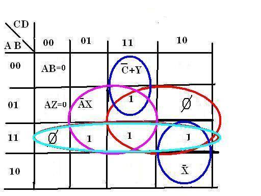

so i asked to find the minimum SOP function from the Karnaugh map (given in the picture).
so i started to solve it as you can see in the picture.
and this what i got:fsop=AB+BC+ACD'X' till here i think is ok.
now this is all what i tried to do: AB+BC+ACD'X'+A'DY.
hopw you can help me here.
thanks.

What mean the AB, !C+Y, AZ, !AX, !X in map cells?
hey, i just solve it.
i can know the value of A,B,C.
now if i can know what is A,B,C. i get:fsop=BC+AB+ACD'X'+BDX'+A'DY
what i did is first take all the "1" (if i can use with Phi so i also use it).
then i take the Variables (if i can use here with "1" of Phi i use it.)
thank you.
