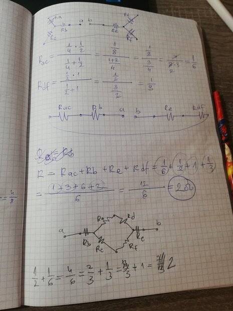

I am supposed to find the equivalent to R2 and I got 2, but I am supposed to get 3

the circuit:
here is what I did:
(english is not my first language so sorry if i get any terms wrong)
I thought R3, R4 and R5 form a triangle so I turned it into a star for easier calculation and I did the same for R6 R7 and R1.
Then I thought R34 and R35 are parallel so I calculated that too and the same I did for R61 and R71.
Then I thought all of them were connected in order meaning I could add them all together.
That is:
R3435 +R45 + R67 + R6171.
I got the answer 2, I need to get 3.
Where did I go wrong?

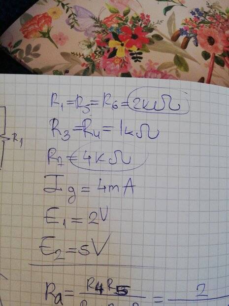

I am not sure as to how write that. I can draw it, but I don't know how to write those steps.
If you mean calculating new Rs it's just basic multiplication and I have in the picture.

I cannot read the component values.
You do not need the Y to Δ transform.
Current source Ig is infinite resistance, so remove it from the circuit.
Voltage sources, E1 and E2 are zero resistance, so short them.
R1 = R5 = R6 = 2k;
R3 = R4 = 1k;
R7 = 4k.
Series; +
Parallel; //
R16 = R1 + R6 =
R34 = R3 + R4 =
R167 = R16 // R7 =
R345 = R34 // R5 =
R2 = R167 + R345 = 3k.

I am not sure I understand...
The way I do it, I imagine that power is flowing from a to b and so when it's going from a the power splits in two because of R4 and R5 and thus making them parallel. Why isn't it like that?
Yes, you can do it in the longer way using the inverse Y to Δ transform;
https://en.wikipedia.org/wiki/Y-Δ_transform
Your mistake is that you have the current source, Ig = 0 ohms, as a short circuit, which is wrong. A current source has infinite resistance, which is an open circuit.
You do not need the Y to Δ transform if you make the current source = ∞ ohms.
