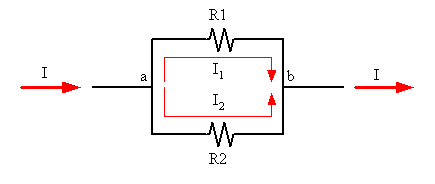

Okay. Consider the circuit fragment in the attached figure. A current I enters from the left and at the node marked a splits into two separate paths with different resistances R1 and R2, then rejoins at he node marked b before continuing on. The current that "chooses" to flow through resistance R1 is I1, and the current through R2 is I2.
Clearly I1 + I2 = I. The current divides so that
[tex] I_1 = I \frac{R2}{R1 + R2} [/tex]
[tex] I_2 = I \frac{R1}{R1 + R2} [/tex]
Note that if you add I1 and I2 you get
[tex] I_1 + I_2 = I \frac{R1 + R2}{R1 + R2} = I [/tex]
Alright so far?
Example: Suppose I is 10 Amps, R1 is 3Ω and R2 is 7Ω. Then the current through R1, the 3Ω resistor, is
10A * 7Ω/(3Ω + 7Ω) = 10A * 7/10 = 7 Amps.

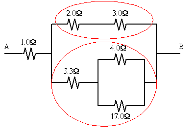

Now in your circuit the first such split occurs after the current passes through the 1Ω resistor. In my previous post I circled the components in the two paths.
If you can find the total resistances of these individual paths, then you can apply the current divider rule to find the current flowing into the lower path. Next, armed with the current entering this path, you can face the split contained within it in a similar fashion; the current in the lower path divides between the 4.0Ω resistor and your 17Ω resistor. Your aim is to find the current that flows in that 17Ω resistor.

I notices that previously you determined the total current supplied by the battery. That was, what, 2.087A? (I keep a few extra decimal places for intermediate results -- avoids rounding errors making a hash of things later). That current will be entering the network at node A, and leaving by node B.
What's the numerical values of the resistances for the two paths that I had previously indicated by red circles?
yeah I rounded up to 2.1 but 2.089 I think was may actual value. the second path the one we're working on has a 3.3 ohm resistor then two broken into parallel resistors of 4 and 17ohms. for the first path it's just a series of a 2 and 3 ohm resistor.

Yes, and their net resistances are...?
sorry for the first path it's 5 because you just add the resistances, and for the second it's 6.54 if I'm figuring it out right.

Correct. So now with the total current and these two resistances you can find the current that's entering the lower path using the current divider method. Can you do that and show the result?

Sorry, no. 8V is a voltage, not a current. You calculated the total current driven by the 8V source previously. I = 2.087A. You did this by first finding the overall equivalent resistance of the network of resistors (call it R) and then calculating 8V/R. Right?
The current divider method works with currents, not voltages.
So, once again, can you calculate the current in the lower path?

2.087A is the total current flowing from A to B. After passing through the 1 Ohm resistor it splits into two paths, an upper path that has two resistors in series (2 and 3 ohms), and the bottom path containing three resistors in a slightly more complicated configuration. You want to find out how much of that original 2.087A is flowing via this bottom path.
You have calculated the total resistances of the two individual paths. You have the total current. You have the current divider rule. You want the current in the lower path. I don't know how I can be more explicit.

The current divider rule determines the fraction of the total current, I, that splits off and flows through a given path. If you look closely at the rule, it states that the fraction of the current that flows through a given path is equal to the resistance of the *other* path divided by the sum of the resistances of both paths.
By placing the resistance of the lower path in the numerator of the ratio, you've actually calculated the current flowing through the upper path rather than current in the lower path. So replace the 6.54 quantity in the numerator with 5, the resistance of the upper path. this will give you the current in the lower path. What value do you calculate?
