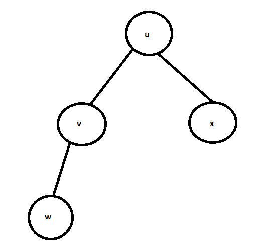

Hello! (Wave)
Twitter is testing a new function where each publication that someone makes gets republished automatically by each of his followers. The functions works <<sequentially>>, i.e. each republication from a follower causes republication also from his followers and so on. However, in any case, the publication/republication of the news is done at most once from the account of each user. I want to model the problem using graphs and write and analyze an algorithm that computes for each user the total number of publications/republications that occurs with each of his publication.
I have thought the following.
We consider a graph, where the users of twitter will be represented by the vertices. If someone follows someone else, then the vertices will be connected with an edge.
So we begin with the first user that makes the publication. This will be a vertex with no incoming edges.
Then we visit the neighbors of the vertex, that means the followers of the user.
Since, when one user makes a publications, all of hisfollowers make the same publication, we follow the idea of the DFS algorithm.
The number of times that the publication will be replubished will be equal to the finishing time found at the last visited vertex to which there is a path from the inital vertex.
So, the algorithm that counts the total number of republications that occur from a publication of a user is the following:

Does this algorithm computes for each user the total number of republications that occur with his publication? (Thinking)
Wouldn't this first user possibly have incoming edges as well?
They can follow other people too that may independently be making publications. 🤔

So V is the set of all users of twitter, and E is the set that represents who is following who.
Where is the "first user"? Shouldn't that be an input as well? 🤔
What does the output array F contain?
Shouldn't the "total number of republications that occur from a publication of a user" be an output? 🤔
Where does the output F get a value?
And shouldn't "time" be used somewhere? 🤔

So we consider the graph G that contains all the vertices that are connected to u, which represents the first user that makes a publication, and there is an edge if the user follows or is followed by someone.
What kind of variable will the publication be?
I have thought of the following algorithm:

And we would need to call this function for each publication that a user makes and for each user.
Is my idea right? (Thinking)

How are the number_of_republications and the time related to each other?
As it is now, isn't the number_of_republications simply the number of nodes that we are visiting?
If so then we don't need a time do we? 🤔
How about:
Code:
Algorithm Republications
   Input G=(V,E), vertex u in V of user that makes one initial publication
   Output number_of_republications
   for each v in G.V do
        color[v]<-WHITE
   number_of_republications<-0
        if color[v]=WHITE then
           number_of_republications += dfs_visit(G,v)
   return number_of_republications
where we assume that dfs_visit returns the number of WHITE nodes visited, and where we also assume that dfs_visit removes the WHITE color of visited nodes? :unsure:
Furthermore, the user u is not supposed to republish their own publication.
So shouldn't we make sure that does not happen? 🤔

Does it hold that the dfs-algorithm returns the finishing time of the last visited vertex, which is the number of nodes that have been visited?

If that what I said above about the dfs-algorithm is true, then don't we have to check at the point where we enter the iteration:
Code:
if there is an edge betwenn u and v? Because otherwise if there is a user that isn't connected to the first user, we will add number of republications that are not connected with the publication of the first user. Or am I wrong?

The Depth-first search algorithm doesn't actually do anything other than visiting all nodes.
We need to specify the behavior we want from it.
That could be to return the number of nodes it visited. :unsure:
Code:
Ah, we forgot to use u and instead we started from every v in the graph.
We should only start from u.
So perhaps instead:
Code:
number_of_republications ← dfs_visit(G, u)
:unsure:
Do we check this in an other algorithm, where we call the function Republications?
Because in this algorithm all the publications occur from the publication of the first user. Or am I wrong?
No.
I misinterpreted the for-loop, which shouldn't be there to begin with as I've just explained.
With the correction, u will be counted as the first node visited, which is the publication, and it will be marked as discovered.
After that the algorithm won't try to do a republication for u if it happens to return to it. 🤔

The number of nodes visited will be equal to the finishing time of the last visited vertex, given that from the vertex that we give us input to DFS there is a path to each other vertex, right? (Thinking)
So, the algorithm would be as follows, right?
Code:
Algorithm dfs_visit(G,u,time)
   time<-time+1
   color[u]<-GRAY
   for each v in G.adjacent(u) do
        if color[v]==WHITE then
            dfs_visit(G,v,time)
  color[u]<-BLACK
  time<-time+1
 return time
So perhaps instead:
Code:
number_of_republications += dfs_visit(G, u)
:unsure:No.
Applying the DFS with u as input, we find the number of republications that occur from a publication of u.

Now suppose u is followed by v who is followed in turn by w.
And suppose u is also followed by x who does not have followers.
Then at the top level we will see:
time ← 1
time ← dfs_visit(G,v) = 2
time ← dfs_visit(G,x) = 1
return time = 1
But we should have a total time of 1+2+1=4 shouldn't we? 🤔
time ← 1
return time = 1
We can fix it by making it:
time ← 1
time ← time + dfs_visit(G,v) = 1+2 = 3
time ← time + dfs_visit(G,x) = 3 + 1 = 4
return time = 4
The graph would be as follows, right? (Thinking)
Suppose that we make a DFS-traversal and we start with the neighbor v of u, then we visit w, and then x.
If the time would be 1 for example at the vertex u, the time of v would be 1, the time of w 2 and the time of x would be 3.
Isn't that the idea of DFS? Or have I understood it wrong? 🧐 🧐 🧐
evinda said:
I thought to set at the beginning the variable "time" equal to 0, since we are looking for the number of republications. If the user has no followers, we will have no republication. Is it wrong like that?
I'm afraid it's wrong.
The "problem" is that dfs_visit is a recursive function.
When dfs_visit is recursively called to visit v, the time is set to zero as well for v, while this is a republication. :oops:
Yep. That is the graph. (Nod)
The idea of DFS is simply that we visit all nodes exactly once.
And we can return something we want to track - in this case the time spent in each subgraph. 🧐
Either way, when would 'time' become different from 0 in the algorithm as it is now? :unsure:

Code:
   time<-0
        color[v] ← WHITE
   Algorithm dfs_visit(G, u)
     color[u] ← GRAY
            time ← time + 1
            dfs_visit(G, v)
   EndAlgorithm
   dfs_visit(G, u, time)
   return time
For the record, we are already doing the same thing with color. 🤔
evinda said:
4.
How would we specify "time" in the specification of dfs_visit?
Something like:
Code:
Algorithm dfs_visit(G, u, time)
  Input: G=(V,E)
  Input: vertex u in V of user that makes either a publication or a republication
  Input-Output: time to which the time spent is added
  color[u] ← GRAY
        if color[v] == WHITE then
           time ← time + 1
           dfs_visit(G, v, time)
To be fair, I haven't seen such a combined Input-Output in algorithm-pseudocode syntax yet, but many programming languages support it, so it makes sense that we can use it if we want to. 🤔
We can do:
Code:
  time ← 1
  color[u] = GRAY
      time ← time + dfs_visit(G, v)
  return time
That is, we add the return value of dfs_visit to time.
We do have to start at 1 instead of 0 to make it work though. 🤔
Something like this:
Code:
  color[u] ← GRAY
           time ← time + 1
           time ← dfs_visit(G, v, time)
  return time
That is, dfs_visit return the time as output.
The time that was changed inside the call to dfs_visit will no longer be accessible.
So we need to pick up the return value and overwrite the previous value that we had. 🤔
The last algorithm gives the right output, but doesn't the previous one give the output it should+1? 🤔
Basically yes. (Nod)
Note that many programming languages allow a local variable to be accessible inside another local function.
That is, we could have:
Code:
   time<-0
        color[v] ← WHITE
     color[u] ← GRAY
            time ← time + 1
            dfs_visit(G, v)
   EndAlgorithm
   return time
So if "time" is a global variable and we want to write the two functions seperately, we would have the following, right? (Thinking)
Code:
  color[u] = GRAY
      time<-time+1
      dfs_visit(G, v)
Code:
   time<-0
        color[v] ← WHITE
   dfs_visit(G, u)
   return time
If we want, we can subtract 1 from the result when we call dfs_visit from the Republications algorithm. 🤔
evinda said:
So if "time" is a global variable and we want to write the two functions separately, we would have the following, right?
Yep. (Nod)
Yep. (Nod)
Nice, thank you very much! (Clapping)
