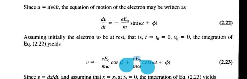

When
dv/dt= -qE/m(sin(ωt+φ))
Find v
Then x
By integrating

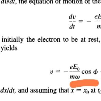

From text , i like to know where -eE/mw(cosphi) come ?
Is it should be C instead after integrate sin(wt+phi)
The problem says that the electron is initially at rest, so you can determine the value of the constant of integration C.
