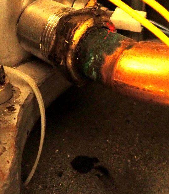

This is the leaky fitting in my boiler. The leak rate is about 0.5 bar pressure drop in 6-8 months. The gunk is from antifreeze in the system. Without antifreeze, there would typically be some mineral deposits. There would normally not be visible water. The antifreeze is because of the water lines running through the unheated garage to the air handler in my shop. The HVAC guy will fix it when he gets a chance.
Several years ago, my domestic water system had a leak. The leak rate was about 5 drops per minute, and roughly one gallon per day. That one was easy to find.
