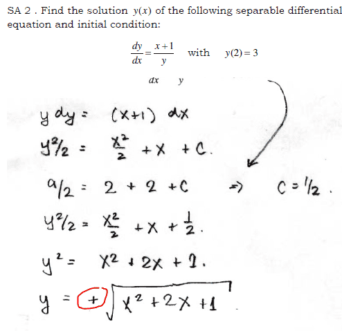

What about this question? Why is the negative answer from taking the root of y^2 rejected?
Is it because y has a discontinuity at 0 and thus because our initial condition y(2) = 3 starts in the positive y the solution must vary between 0 < y < infinity?
I just want to clarify this one because it is slightly different when compared to my original question in that the discontinuity is y instead of t or x.
Thank you!
You would want the solution corresponding with the positive initial condition, so yes you ignore the negative case.
