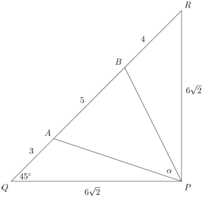

If $QA=3$, $AB=5$ and $BQ=4$ then the other two sides of the triangle $PQR$ will both be $6\sqrt2$ units.Cosine rule in triangle $PQA$: $AP^2 = 9 + 72 - 2\cdot 3\cdot 6\sqrt2\cdot\dfrac1{\sqrt2} = 45$.
Cosine rule in triangle $PRB$: $BP^2 = 16 + 72 - 2\cdot 4\cdot 6\sqrt2\cdot\dfrac1{\sqrt2} = 40$.
Cosine rule in triangle $APB$: $\cos\alpha = \dfrac{40 + 45 - 25}{2\cdot\sqrt{40}\cdot\sqrt{45}} = \dfrac1{\sqrt2}$.
Therefore $\alpha = 45^\circ$.[/sp]

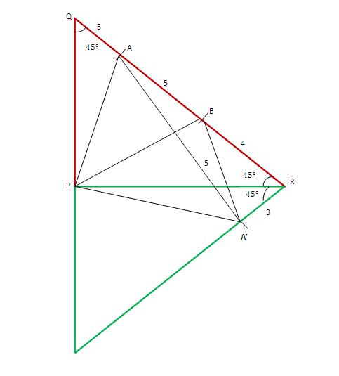

Here is another approach that tackles the problem using the geometry route that I want to share with you:
If we rotate the triangle $PQR$ about $P$ by $90^{\circ}$, the point $Q$ goes to $R$.
Let $A'$ represent the image of point $A$ under this rotation. Then we have
$RA'=QA$ and $\angle PRA'=\angle PQR=45^{\circ}$ so $BRA'$ is a right-angled triangle with $RB:RA'=4:3$, $\therefore A'B=BA$.
It follows that $PABA"$ is a kite with $PA'=PA$ and $AB=BA'$. Therefore $PB$ is the angle bisector of $\angle APA'$. This implies $\angle APB=\dfrac{\angle APA'}{2}=45^{\circ}$.
