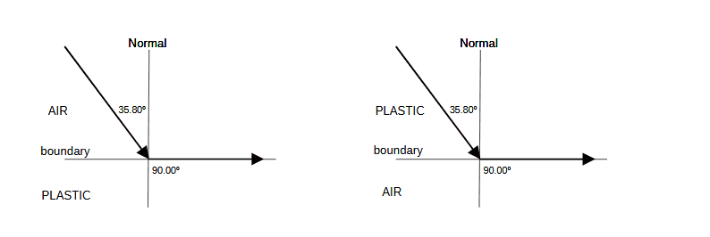

The critical angle for a certain piece of plastic in the air is 𝜃_𝑐 = 35.80. What is the critical angle of the same plastic it is immersed in water.
n1sin𝜃 = n2sin𝜃
arc_sin𝜃 = n2/n1
Attempt one:
1sin(35.8) = n2sin(90)
n2=0.58
1.33sin(𝜃)=0.58sin(90)
𝜃_c=25.8
Attempt two:
n1=n2/sin𝜃_c
n1=1/sin(35.8)
n1 = 1.7
sin𝜃_c = 1.33 / 1.7
𝜃_c = 51.57

Do you think the light is travelling from air into plastic? Or from plastic into air?
Hint1: Why should gettting a refractive index of 0.7 makes you worry about violating the lawys of physics?
Hint2: You might want to note that the given value of critical angle has 4 significant figures. Will that affect your working? (Correct answer=yes!)

In addition to all the above correct comments, did you make a sketch of the setup?? That is the correct approach to any problem! It matters which is medium 1 and which is medium 2 for angles labelled ##\theta_1## and ##\theta_2##. You mixed them up.

There was no value for index of refraction given in the problem, I had to solve for what it was for plastic and make the assumption that it was 1.33 for water
That's a correct assessment for the water. For the plastic you have two values, n = 0.58 and n = 1.7. Which one do you believe is correct and why? You have already been given several hints.
1.7
Good choice. That's what I would say it is for reasons already explained. So what do you think the critical angle from plastic to water is?

It's not a case of 'more corecct'. One attempt is correct. The other is wrong.
Only one of the following diagrams is correct. The correct diagram leads to the correct equation and the correct answer.
You need to undestand why the incorrect diagram (which one is it!?) is incorrect.
