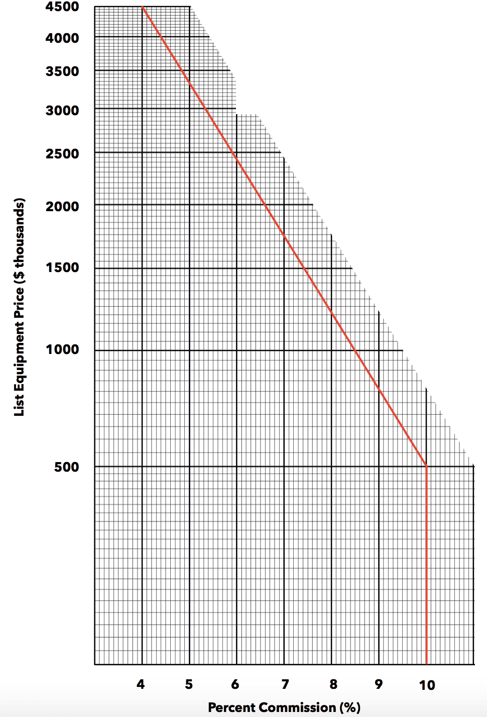

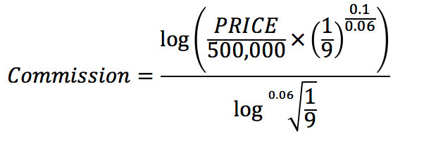

I've spent some time researching and trying to find an equation for this line, but it's not exact. I'm only searching for the equation of the line that descends towards zero (the angled line). I plugged in some numbers and it does not match the graph, the line on the graph is steeper. I start with y=a*b^x, solve for a and b then solve to show what x equals (commission). I followed some log rules and end up with the equation you see below in the image.
Can anyone help me find the equation?View attachment 7643

It seems you are making this more complicated than it needs to be - the line is straight - so a linear model should be sufficient. Can you find a linear equation that represents the line?

I think the y-axis is intended to be a logarithmic scale. Is the y-axis number scale wrong? Is that the problem?
The line was placed on some generic log scale graph, then a line was drawn.

If I try to find the slope of the line segment with end points at prices 500 and 4500, I get $\frac{10\%-4\%}{\log(500) - \log(4500)} = -0.0628771$.
And from the formula the slope should be $\dfrac{1}{\log\sqrt[0.06]{\frac 19}} = -0.0628771$.
So that is a match.

Thank you. Are you saying my equation is correct? Because when I go to plug in 1,500 as the price I get 7% commission. But, on the graph it's more like 7.4%. and that's where I'm confused. Maybe the scale of the graph is off?

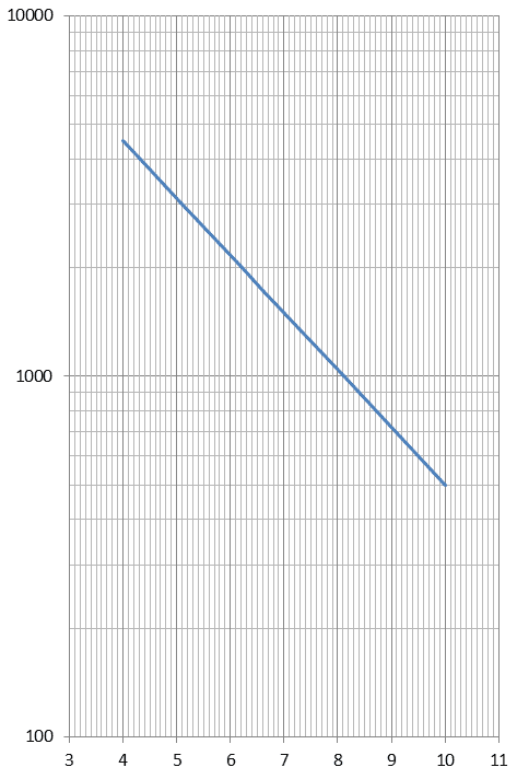

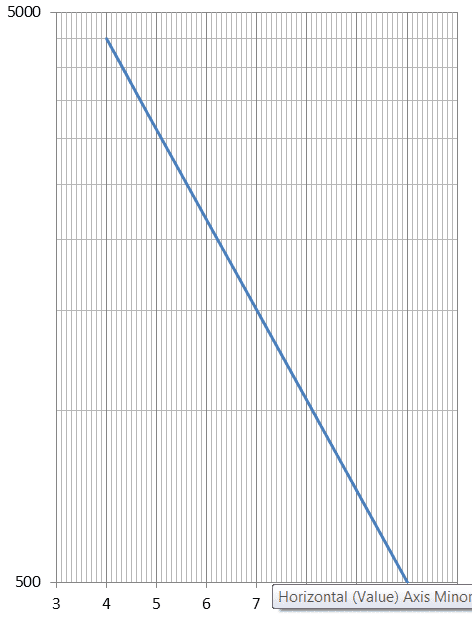

Indeed!
The numbers have been placed wrong on the graph paper.
The graph should look like:
If I'm not mistaken, it could be fixed by putting all prices one line down.
That is, the 500 should be at the bottom. And 5000 should be at the top.
That is:
