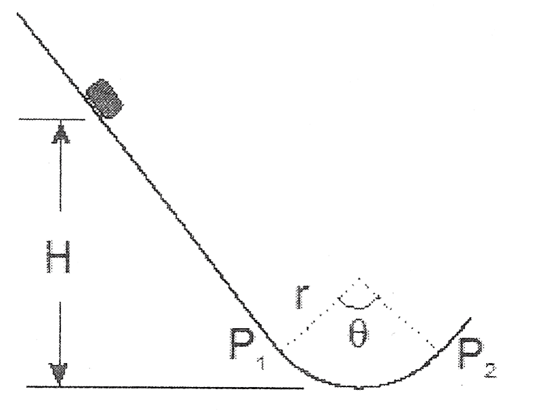

An object of mass m=200g slides down a frictionless ramp from a height H= 60 cm. Near the bottom of the ramp, the path changes into an arc of a circle with radius r= 20 cm. The arc has coefficient of kinetic friction μk=0.4. The angle θ=120° and points P1 and P2 which are the ends of the arc, are at the same height.
Questions:
*What is the speed of the object at point P1?
*What is the kinetic energy of the object at point P2?

Finding the speed at point P1 is done through a simple application of the Work-Energy Theorem (letting U0 be at the bottom of the arc):
[itex]
{\Delta}H=H-r+r\sin{60^{\circ}}
[/itex]
[itex]
mg{\Delta}H=\frac{mv^2}{2}
[/itex]
[itex]
v=\sqrt{2g{\Delta}H}
[/itex]
[itex]
v=\sqrt{2\left(9.80665 \,\mathrm{m/s^2} \right)\left(0.4+0.2\sin{60^{\circ}} \,\mathrm{m} \right)}
[/itex]
[itex]
v \approx 3.35298\,\mathrm{m/s}
[/itex]
Finding the kinetic energy at P2 is much more difficult. Here, the surface transforms from a frictionless one to one with coefficient of kinetic friction 0.4. Since the height of P1 is the same as at P2, ΔU=0. Furthermore,
[itex]
{\Delta}K=\frac{mv_f^2}{2}-\frac{mv_0^2}{2}
[/itex]
and
[itex]
{\Delta}E_{therm}=F_ks_{rel}=\mu_kF_ns_{rel}
[/itex]
The problem is that Fn is dependent on the angle at which the force of gravity acts relative to the surface of the curve. Additionally, the net force on the object is equal to the centripetal force on the object, [itex]\frac{mv^2}{r}[/itex]. Thus, to calculate the force of friction it becomes necessary to account for a variable force which is dependent on position and velocity. Velocity is also dependent on the force of kinetic friction.
The normal force is
[itex]
F_n=mg\cos{\phi}+\frac{mv^2}{r}
[/itex], where phi is the angle between the force of gravity and its component parallel to the normal force. Thus, the thermal energy is equal to:
[itex]
{\Delta}E_{therm}=F_ks_{rel}=\mu_k \left( mg\cos{\phi}+\frac{mv^2}{r} \right) s_{rel}
[/itex]
The total distance srel is the arc length, [itex]\frac{2\pi r}{3}[/itex].
Thus, the problem becomes deriving an expression for Fk in terms of position or angle which can be integrated to find the work done by the force.

You never mentioned what the problem is to solve. You just gave some information.
Trying to find the KE at P2. I updated the original post.
Seems I forgot to actually write the problem statement as I was fixing some LaTeX mistakes...
I could be mistaken but I think your delta H for the velocity at P_1 is wrong?

Isn't [tex] \Delta H = H - (r-rcos\theta)[/tex]?
Not sure how do figure out the second part, I'd like to know though =\

Actually, I think you're right...
That would make [tex] K_i = 0.980665 \,\mathrm{m/s} [/tex].
I figure that the initial decent for the first part of the problem is
Δy = - H + r( 1 - cos(θ/2) )
I guess y'all are calling the change in height ΔH rather than Δy. Anyway, other than that sign reversal, I figure that the angle should be half of the angle between P1 and P2.

Here, I must apologize for sloppy notation. I was using theta to represent both theta and theta/2.

Ignoring the problem mentioned in the previous step, this is the correct idea. It is just a simple change of variables (something that you will learn more about in calculus 2 and 3 where it gets a lot more complicated).
jhae2.718 said:
[itex]\frac{\mathrm{d}K}{\mathrm{d}\phi}=-\left( \frac{-\mu_kmg}{2}+\frac{2K}{r} \right) r[/itex]
At this point you cannot do a straightforward integration, because the K in the integrand depends on the (dummy) path variable, and you don't yet know how. So, this step is where you should get the diff. eq.. The upper integration limit would be a variable (e.g. s or φ) instead of the constant 2π/3, and don't forget to use the "dummy" integration variable (e.g. s' or φ').
In order to get the diff. eq., you will need this "rule" (which is actually not too difficult to prove using the definition of a derivative in terms of a limit, and is closely related to the fundamental theorem of calculus):
[tex]\frac{d}{dx}\left(\int_{x_0}^{x}dx'f(x')\right)=f(x)[/tex]
It's probably important to point out that this "rule" requires f to be a continuous function, at least in a neighborhood of the point x.
(Actually, after writing this definition out for you, I realize that the integral equation can be skipped. But, it's a bit more abstract, and I don't want to confuse you any more than I already have.)
Okay. Try #3...
[itex]
K\left(\phi\right)=K_i-U_i+U\left(\phi\right)-Q\left(\phi\right)
[/itex]
Define U(φ) and Q(φ) as:
[itex]
U\left(\phi\right)=mgr\left( 1-\cos\phi \right) \, d\phi
[/itex]
[itex]
Q\left( \phi \right) = \left(\mu_kmg\cos\phi+\frac{2K\left( \phi \right)}{r} \right) rd\phi
[/itex]
Substituting in and using the dummy variable φ':
[itex]
K\left(\phi'\right)=K_i-U_i+mgr\int_0^\phi{\left( 1-\cos\phi' \right) \, d\phi'}-r\int_0^\phi{\left(\mu_kmg\cos\phi'+\frac{2K\left( \phi' \right)}{r} \right) d\phi'}
[/itex]
Taking the derivative dK/dφ:
[itex]
\frac{dK\left(\phi\right)}{d\phi}=mgr\left( 1-\cos\phi \right)-r\left(\mu_kmg\cos\phi+\frac{2K\left( \phi\right)}{r} \right)
[/itex]
[itex]
\frac{dK\left(\phi\right)}{d\phi}=mgr-mgr\cos\phi-\mu_kmgr\cos\phi-2K\left( \phi \right)
[/itex]
[itex]
\frac{dK\left(\phi\right)}{d\phi}+2K\left( \phi \right)=mgr-mgr\cos\phi-\mu_kmgr\cos\phi
[/itex]
[itex]
\frac{dK\left(\phi\right)}{d\phi}+2K\left( \phi \right)=U \left( \phi \right)-\mu_kmgr\cos\phi
[/itex]
Thanks again for all your help. I really appreciate it...
jhae2.718 said:
[itex]K\left(\phi\right)=K_i-U_i+U\left(\phi\right)-Q\left(\phi\right)[/itex]
Sorry, there was a typo in my previous post, similar to your typo regarding K=Q-Ki. The signs on the potential energies are backwards. This should be
[tex]K\left(\phi\right)=K_i+U_i-U\left(\phi\right)-Q\left(\phi\right)[/tex]
That typo should have stood out as a red flag. We are talking about two states, the initial state indicated by the subscript "i" and the (generalized) final state indicated by the dependence on φ. (The final state for our purpose is the state of the object when it reaches the angle φ, which we allow to vary.) The initial state energy is
Ei=Ki+Ui
and the final state energy is
E(φ)=K(φ)+U(φ)
The energy in any given state is always the sum of the kinetic and potential energies. In a lossless (i.e. frictionless) system, you would have
E(φ)=Ei
However, in the case of our lossy system, the difference between the initial energy and final energy is the accumulated energy loss due to friction, Q(φ). So
E(φ)=Ei-Q(φ)
I hope that all such typos will be obvious now.
jhae2.718 said:
[itex]U\left(\phi\right)=mgr\left( 1-\cos\phi \right) \, d\phi[/itex]
[itex]Q\left( \phi \right) = \left(\mu_kmg\cos\phi+\frac{2K\left( \phi \right)}{r} \right) rd\phi[/itex]
These energies are not differential energies, but cummulative energies. In particular, you do not need an integral to express U(φ); it is just the value of the gravitational potential energy when the object is at φ. Q(φ) needs to be expressed as an integral, because it is nonconservative (not a state property).
BTW, I just noticed another detail. The second term in your integrand for Q is just the normal force, not the friction force, so you need to fix that (a simple fix).
jhae2.718 said:
[itex]K\left(\phi'\right)=K_i-U_i+mgr\int_0^\phi{\left( 1-\cos\phi' \right) \, d\phi'}-r\int_0^\phi{\left(\mu_kmg\cos\phi'+\frac{2K\left( \phi' \right)}{r} \right) d\phi'}[/itex]
I'm assuming that you're defining φ as the angle from the downward vertical. If so, then the lower limit on the integral should not be φ'=0 unless you somehow know the kinetic energy at that point. Rather, you know the initial kinetic energy at a different value of φ, and that should be your lower limit.
Actually, this doesn't matter from a practical standpoint, since the derivative of the integral does not depend on the constant lower limit, but you should try to understand the expressions that you are writing. Think of the integral as a mathematical description of an accumulated effect from some starting point to some ending point. In our case, the starting point is when the friction begins to act, and the ending point is the variable position, φ.
[itex]\frac{dK\left(\phi\right)}{d\phi}=mgr\left( 1-\cos\phi \right)-r\left(\mu_kmg\cos\phi+\frac{2K\left( \phi\right)}{r} \right) [/itex]
OK, you correctly used the "rule" for differentiating the integral, but the you need to go back and fix your implementations of U and Q (and the minus signs - sorry again for that typo). You are getting closer.
I should have seen that, but lately I'm making more mistakes than usual...
[itex]
[/itex]
[itex]
[/itex]
[itex]
Q\left( \phi \right) = \mu_kr\int_{\phi_0}^\phi{\left(mg\cos\phi+\frac{2K\left( \phi \right)}{r} \right) d\phi}
[/itex]
Substituting in and using the dummy variable φ' (φ0 is the angle φ at the point where motion on the circle begins):
[itex]
K\left(\phi\right)=K_i+U_i-mgr\left( 1-\cos\phi \right) -\mu_kr\int_{\phi_0}^\phi{\left(mg\cos\phi'+\frac{2K\left( \phi' \right)}{r} \right) d\phi'}
[/itex]
[itex]
\frac{dK\left(\phi\right)}{d\phi}=-mgr \sin\phi -\mu_kr \left(mg\cos\phi+\frac{2K\left( \phi\right)}{r} \right)
[/itex]
[itex]
\frac{dK\left(\phi\right)}{d\phi}=-mgr \sin\phi -\mu_kmgr\cos\phi-2\mu_kK\left( \phi\right) \right)
[/itex]
[itex]
\frac{dK\left(\phi\right)}{d\phi}+2\mu_kK\left( \phi\right)=-mgr \sin\phi -\mu_kmgr\cos\phi
[/itex]
[itex]
\frac{dK\left(\phi\right)}{d\phi}+2\mu_kK\left( \phi\right)=-mgr \left( \sin\phi +\mu_k\cos\phi \right)
[/itex]
jhae2.718 said:
[itex]Q\left( \phi \right) = \mu_kr\left(mg\cos\phi+\frac{2K\left( \phi \right)}{r} \right) d\phi[/itex]
This is not quite correct. This is a differential quantity, but it should be an integral, rather. I really want you to understand that for the sake of your future education (if you are going to use applied calculus). You should try to be more careful with your expressions. But, anyway, when all is said and done we arive at the same diff. eq.
jhae2.718 said:
[itex]\frac{dK\left(\phi\right)}{d\phi}+2\mu_kK\left( \phi\right)=-mgr \left( \sin\phi +\mu_k\cos\phi \right)[/itex]
In order to solve this, you need to determine the integrating factor. This is part of a basic diff. eq. "trick" to write the l.h.s. as a simple first derivative. That is, if you have
dy/dx + f(x).y(x) = g(x)
then you are looking for a function, h(x), so that
h(x).dy/dx + h(x).f(x).y(x) = h(x).g(x)
can be rewritten as
d[h(x).y(x)]/dx = h(x).g(x)
See if you can figure out what is your integrating factor (which will be a function of phi). Hints: do a google search for "integrating factor"; think "product rule".
The solution of the diff. eq. will be in terms of an integral. See if you can also figure this out. Hint: the same google results will probably be helpful here.
I know; I forgot to include the code for an integral; I find that sometimes I forget parts of the expression when writing Latex code. (I almost forgot to include the "mg" term in Q, for example...)
can be rewritten as
The integrating factor, if I'm correct, should be [itex]e^{2\mu_k\phi}[/itex]. Wikipedia's article on integrating factors is actually pretty good...I'll post the full integral later when I have time to work on it, but I'm thinking it will require integration by parts and solving for the unknown integral...
You're certainly not the only one with that problem.
That's what I get.
jhae2.718 said:
... the full integral ... I'm thinking ... will require integration by parts ...
Not necessarily. It actually turns out to be a rather friendly integral, as integrals go. By all means, integration by parts may be a good way to go, but there are other ways that you should also be aware of if you want to develop a skill at solving these kinds of problems. Alternatives include using a computer program, a basic table of integrals, or Euler's identity.
I know, but using a computer program (such as Wolfram|Alpha, which I like to use to check answers...) or a table is just no fun...
As far as Euler's identity goes, I'm guessing that would be done in the form [tex]e^{\pi\theta}=\sin\theta+i\sin\theta[/tex]...how do you manipulate the integrand to do this? (I'm pretty sure this isn't a calc I topic...) Edit: Never mind; I looked it up online...
Thanks for the help. Hopefully, I'll have time to post my answer tomorrow, as I'm going to wait to do the integral, following the rule of "Never trust the result of an integration/differentiation proved after 11 PM..."
After integration, I get:
[tex]
K\left( \phi \right) = C e^{-2\mu_k\phi}-mgr \left[ \frac{ \left( 2 \mu_k+1 \right) \sin \phi + \left( 2 \mu_k^2-1 \right) \cos \phi}{4\mu_k^2+1} \right]
[/tex]
Substituting in known values and solving for C for the case φ=-π/3, K=0.98J, this leads to:
[tex]
K\left( \phi \right) = 0.2278e^{-0.8\phi}-0.3923\,\mathrm{J} \left( \frac{1.8\sin\phi-0.68\cos\phi}{1.64}\right)
[/tex]
Now, either i did the problem incorrectly, or the answer given is incorrect, as I find that when φ=π/3 (i.e., the object is at P2), K(φ) is negative. Solving for φ when K(φ)=0 gives the block stopping at about 20.8 degrees...
[tex]K\left( \phi \right) = C e^{-2\mu_k\phi}-mgr \left[ \frac{ \left( 2 \mu_k+1 \right) \sin \phi + \left( 2 \mu_k^2-1 \right) \cos \phi}{4\mu_k^2+1} \right][/tex]
It may be a trick question, e.g. the object doesn't make it to [itex]\phi=+\pi/3[/itex], I don't know. My first suspicion would be that you made an algebraic error, and you should have [itex]2\mu_k^2+1[/itex] rather than [itex]2\mu_k+1[/itex] in the first term in the denominator that multiplies the [itex]\sin\phi[/itex], maybe. Also, I think it may be easier to just use a definite integral with definite limits of integration. I don't really want to do that integral, even though it's not too scary, just because I'm lazy. But, if you post your expression for K in terms of the unsolved but explicit integral, then I can easily check if we agree at least up to that point.
If you are still having problems that can't be resolved by any of those three suggestions, then I will consider doing the integral myself to compare with yours.
[tex]
[/tex]
I got
[tex]
K\left( \phi \right) = C e^{-2\mu_k\phi}-mgr \left[ \frac{ \left( 3 \mu_k \right) \sin \phi + \left( 2 \mu_k^2-1 \right) \cos \phi}{4\mu_k^2+1} \right]
[/tex]
and positive KE at the end.
ehild.
Seems it was an algebraic error.
ehild said:
I got
[tex]
[/tex]
and positive KE at the end. ehild.
After redoing the integral, I get the same expression.
Then, solving for C, I get [tex]C=0.28158[/tex], and [tex]K\left(\frac{\pi}{3}\right)=0.28792231\ \mathrm{J}[/tex]
Thank you both for all of the help.
Well, I made a mistake with the numbers, and get -0.045 J now, using g=9.81 m/s2. Anyway, it was a nice problem!
ehild
  • #31
It seems that I used the wrong value for C to get positive KE. I get -0.045 J as well after using the value for C I have above...
So, it seems that the problem's answer was incorrect, as I find that the KE becomes zero at around 53.4 degrees...
  • #32
jhae2.718 said:
So, it seems that the problem's answer was incorrect, ...
Do you have an official answer that we can compare to?
  • #33
0.71 J is the book's answer; unfortunately there isn't anything given to support that answer.
  • #34
Sorry, I see that you included the official answer at the bottom of your first post.
I "solved" it, and I also get a negative value for the final kinetic energy at φ=+π/3. I will have to think about this some more.
