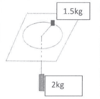

If a ##1.5## kg mass is rotating at uniform speed on a table and another ##2## kg mass is connected with a string which goes through the hole on the table at the center of rotation of the ##1.5## kg mass making the ##2## kg mass hanging then what should be the speed of rotation of the ##1.5## kg mass to keep the ##2## kg mass stationary?
Coefficient of sliding friction of the ##1.5## kg mass is ##μ_k=0.2## and the string is inextensible.

**My Attempt:** Here, I considered for 2 kg mass the resultant motion is zero, which means it's acceleration (a) would be zero. So, if we consider the Tension force from the 1.5 kg mass to keep 2 kg mass from falling is L, then 2×9.8-L=ma=2× 0 ⇒ L=19.6 N. But where does the tension force from 1.5 kg comes from? I thought it's from the centrifugal (or centripetal) force. But should I take into account friction now? If the friction is fk then can I write this ##\frac{mv^2}{r}-f_k-L=0## in the next step to find out speed of the 1.5 kg mass?

For the 2-kg mass to be stationary, the centripetal force ##F_c## on the 1.5 kg mass must match the hanging weight. Now ##F_c=\dfrac{mv^2}{r}##. Because friction changes the kinetic energy and hence the centripetal force, the value of the speed at which the centripetal force matches the hanging weight is only instantaneous. Thus the mass cannot be stationary if friction is taken into account.
To @nazmulhasanshipon: Are you sure you have translated the statement of the problem faithfully?

The question strikes me as ambiguous. Is the table stationary or rotating?
If stationary then, as @kuruman notes, the hanging mass cannot remain stationary. It will only be instantaneously so.
But if the table is rotating and the mass stationary wrt it then the relevant coefficient is static friction, not kinetic, and the answer will be a range, not a single value.
@nazmulhasanshipon , please confirm that the original question a) does not make it clear whether the table is rotating and b) does specify only kinetic friction.

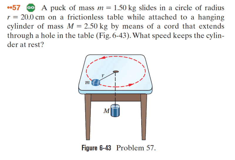

Here is a screenshot from the reference you gave. This version is fine because there is no friction and has an answer to the question being asked. Whoever added the complication of friction, did not modify the question being asked to take friction into account.
Edit: I remember puzzling over this problem as an undergraduate more than 50 years ago. It was in the 1964 edition of "Physics" by Halliday and Resnick.

The solution to the frictionless version? Consider the tension and the balance of forces on each mass.

I didn't keep my solution from more than 50 years ago. I think you should follow @haruspex's advice.

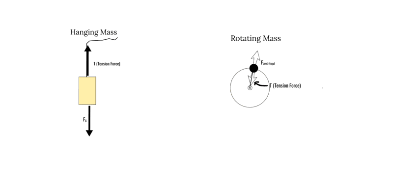

  • #34
Please draw two force diagrams, one for the hanging mass and one for the mass on the table. In each of these diagrams draw the forces acting on each mass and label them with unique symbols that make it clear what they stand for. Post your force diagrams here. We'll take it from there.
  • #35
Is it okay sir? @kuruman
