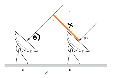

My attempt:
I think ##x## is the path difference so by using trigonometry, I got ##x=d \sin \theta##
But my teacher said the answer is ##d \cos \theta##
What is my mistake? Thanks
Edit: Sorry, I found my mistake. My ##x## is not the path difference
OK, well done.
Tip: Always check a result for extreme cases (like here: ##\theta = 0## and ##\theta = \pi/2##)
songoku said:
My x is not the path difference
Well, it is the difference between the path lines, but not the path length difference.
Thank you very much BvU and haruspex
