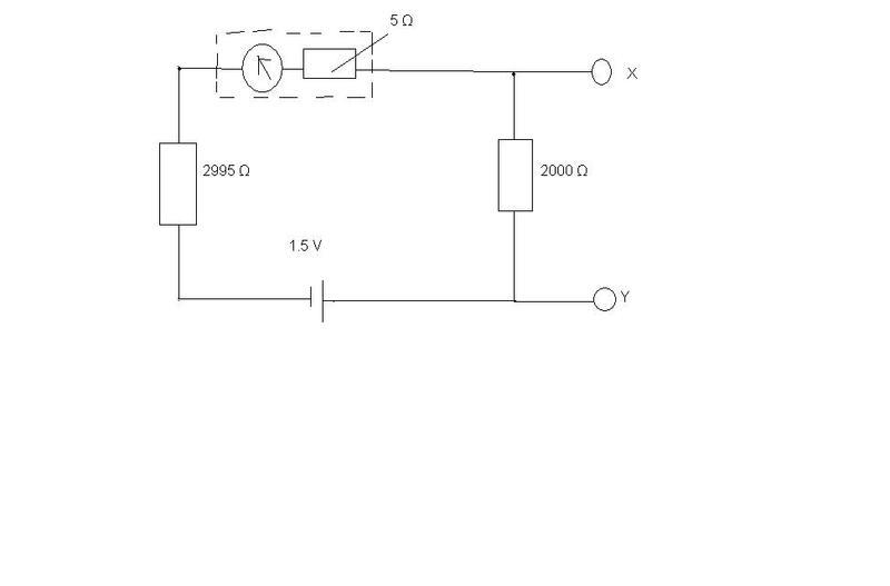

The meter in the circuit shown in the image has an uncalibrated linear scale. With the circuit as shown, the scale reading is 20. Find the scale reading when another 2000Ω resistor is connected across XY.
in the diagram given 2995 and 5 are in series ad they add up to 3000
3000 and 2000 are in parallel so give a resistance of 1200 ohms as a result
and voltage is 1.5 V
there fore i=v/r =1.5/5000=3x10^(-4)
now when a resistance of 2000 is attached across X and Y
then 3000,2000,2000 seem to be in parallel
resultant resistance of these is which give 751.8 ohmsi=1.5/751.8=2x10^-3
there fore scale will show a reading of 6.66
Work out the currents for each setup. Initially, all components are in series.
1) 1.5 volts / ( 3000 ohms + 2000 ohms) =
Now, 2000 ohms in parallel with 2000 ohms = 1000 ohms.
2) 1.5 volts / ( 3000 ohms + 1000 ohms ) =
Then, if the first current = "20" on the linear scale, what does the second current read?
It will read more, won't it?
hey vk6kroarent the 3000,2000,2000 allt hree in parallel?
u have taken the 3000 to be in series with parallel arrangement of 2000,2000
No.
Follow the path of the current from the battery +ve to the battery -ve.
You go through the resistors one after the other, don't you? So they are in series.

Work out the two values with your calculator.
What does this equal:
Add 3000 and 2000 and divide 1.5 by this total.
Add 3000 and 1000 and divide 1.5 by this total.
You should get two currents in Amps.
Now the meter reading will be 20 times the ratio of (current 2 / current 1)

This is exactly what franklinear showed. Neither of you showed how you came up with 1000 ohms though.
elbeasto said:
Hey vk6kro, is the total resistance of parallel resistors equal to the highest resistance resistor divided by the number of resistors in parallel?
I am not a physics major or anything but I do like to toy around with equations. I am sure this is a basic question in your realm.
Parallel resistance, [itex]R_P[/tex] is found using the following formula:
[tex]R_P = \frac{1}{\frac{1}{R_1} + \frac{1}{R_2}}[/tex]
and, for instances where [itex]R_1 = R_2[/tex] you can simplify this by just taking [itex]R_P = \frac{1}{2}R_1[/tex]
Another way of getting the total of resistors in parallel, especially if they are not the same, is this:
Rtotal = R1 * R2 / (R1 + R2)
So, if you have a 39 ohm resistor and a 56 ohm resistor in parallel, you would get the following:
Rtotal = 39 * 56 / (39 + 56) = 29.99 ohms
Or, you can just get 1/39 + 1/56 and take the reciprocal of it.If you have two 2000 ohm resistors in parallel,
Rtotal = 2000 * 2000 / (2000 + 2000) = 1000 ohms
Or, using the other method,
1 / 2000 + 1 / 2000 = 0.001
take the reciprocal to get 1000 ohms.
This still works if you have any number of identical resistors in parallel.
So, if you had 7 resistors all 56 ohms, you would get this:
1/56 + 1/56 + 1/56 + 1/56 + 1/56 + 1/56 + 1/56 = 0.125
The reciprocal of this is 8 ohms.
So the result is 56 / 7 or 8 ohms.
Makes sense because 7 resistors across a power source will draw 7 times as much current as one resistor if they are all identical. So, the combination has 1/7th as much resistance as one resistor.
