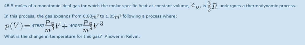

see attached
PV=nRT
So I calculated the final and initial pressures using the given eqns, ended up with the final pressure of 96629 and initial pressure of 62639.
Then I used the PV=nRT eqn to calculate the final and initial temperatures. T=P*V/(n*1.5*R).
I got an initial temperature of 81.79 and a final temperature of 167.747, which is a change in temperature of 85.957 but the answer is 122.74.

So, is there a problem statement somewhere involved here?
Also, attaching units to your numbers would be helpful.
My bad. its attached to this reply
Your pressures are way off. Please redo the calculation.
I don't confirm either of the pressures you calculated. Also, what is that 1.5 factor doing in the denominator of your ideal gas temperature calculation?
