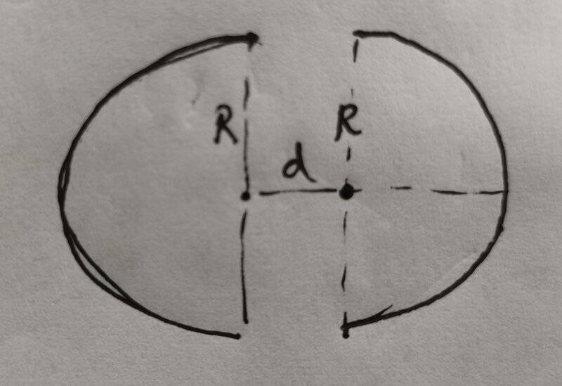

How to calculate a pair of adjacent hemispheres capacitance?
like the picture, two adjacent hemispheres(radius R, distance d, assume the charge is ±Q of each side(assume evenly distributed), can we calculate its capacitance?

What is the definition of capacitance?
The assumption of uniformly distributed charge doesn't lead to equipotential hemispheres. In this case, calculating the capacitance isn't an easy task.
They can't be conductors, so I don't think there is any standard definition of capacitance.
can we assume the electrical field is horizontally paralleled to simply it
Unfortunately, it isn't that simple. I checked whether Smythe had addressed this case but I had no luck.
