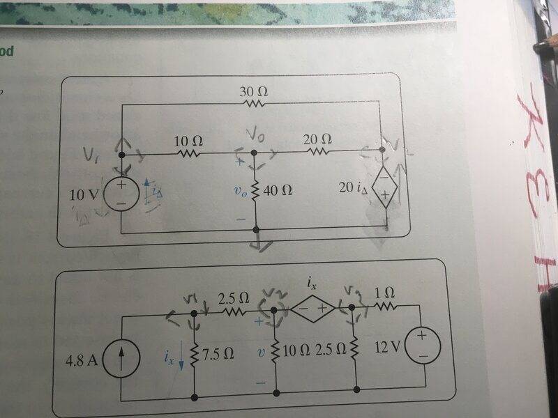

Use the node voltage method to find v0 in the circuit shown.
(V0-v1)/R1 + (v1-v2)/R2+…= 0
What I’m stuck on is finding the constraint equation for i on the top question . I don’t know how to find it when it’s through a voltage source and not over any resistors. (I can’t use ohm‘s law) After I find i the problem should become easy to solve. I know that v1 = 10 and v2 = 20i . The KCL for v0 is (v0-10)/10 + v0/24 + (v0-20i)/20. I could write the KCL for v1 and v2 but that doesn’t address how to find the constraint which is what I need. And when I write them and solve for my answer is way off. Something tells me I need a new approach.
Do us a favour and write them out. There also is a KCL for the bottom node; it should read something like $$i_\Delta + {V_0\over 40\;\Omega}-20\,i_\Delta = 0$$ if I am not mistaken (not an expert here, just searching for ##n## equations with ##n## unknowns)
I suppose you mean $$
{10\; {\sf V}- V_0\over 10\;\Omega} - {V_0\over 40\;\Omega} + {V_2-V_0\over 20\;\Omega} = 0 \qquad ?
$$(considering the penciled arrows)
For v1: -i +(v1-v0)/10 + (v1 - v2)/30
For v2: I don’t know the current going through the dependent voltage source but I do know that current + (v2-v0)/20 + (v2-v1)/30.
Ah, my bad: it's not a dependent current source but a dependent voltage source o:) .
Let me call ##i_3## the current going into the bottom node (named V3...) [edit]from the right
So thus far we have $$ \begin{align*}
{V_0- V_1\over 10\;\Omega} + {V_0\over 40\;\Omega} + {V_0-V_2\over 20\;\Omega} &= 0 \tag{V0}\\ \\
-i_\Delta +{V_1-V_0\over 10\;\Omega} + {V_1 - V_2\over 30\;\Omega}&=0\tag{V1}\\ \\
i_3 + {V_2-V_0\over 20\;\Omega} + {V_2 - V_1\over 30\;\Omega}&=0\tag{V2} \\ \\
i_\Delta + {V_0\over 40\;\Omega}-i_3 &= 0 \tag{V3} \\ \\
V_1 &= 10\; {\sf V} \\ \\
V_2 &= -20\;i_\Delta
\end{align*}$$and now I count 6 equations with only 5 unknowns -- so I must be doing something wrong, still ...

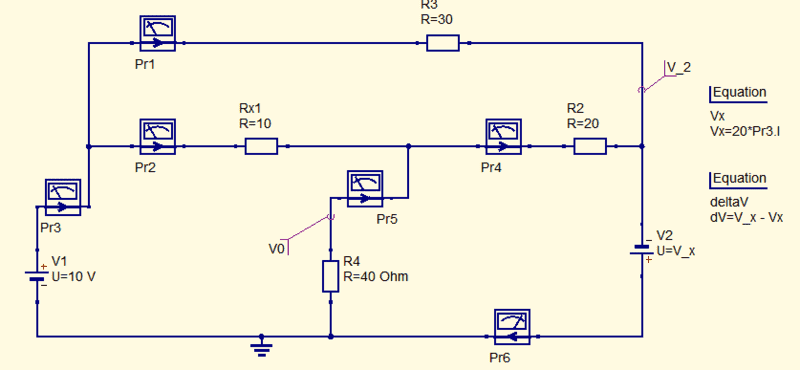

I had a fun day learning the quirks of Qucs (quite universal circuit simulator) :smile: .
Almost converted me to Linux, but that curve I don't think I can handle, so I'll have to live with a buggy windows version.
(You wouldn't believe where you have to go to turn off the grid points in the circuit diagram :mad: )
Can't make it come up with a sensible answer when I use ##\ 20\ i_\Delta\ ## for the dependent voltage (gets 15.2 V but claims V2 = 0 at the same time :headbang: ).
However, when I let step through a range of voltages, a solution emerges. Suppose I can't spoil it under PF rules :oldbiggrin: but at least I can use it to see if the equations in the list are satisfied. Tomorrow (1 AM here :sleep:)...
Hint: do the exercise with ##\infty## for the 40 ##\Omega## resistor ... :wink: piece of cake !

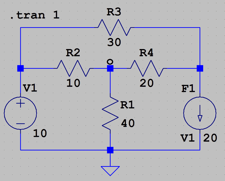

Here is an LTspice .asc file
Very nice. Yet another wrench to get used to in my toolkit :wink: . First impression is better than Qucs (but I am slightly prejudiced - Analog Devices does that for me).
However, my intuition doesn't help me here: how is this
a dependent voltage source delivering ##20 * i_\Delta ## Volts ?@johnsmith7565 : what do you find with my suggestive hint in #7 at the end :smile: ?
BvU said:
... a dependent voltage source delivering 20 * iΔ Volts ?
Look up "F" in the help and you will see that it is a primitive current controlled current source.
The current flowing through voltage source V1 is multiplied by 20.
Can't find a simple current controlled voltage source, but a fixed voltage source with the value as found in #7 does the trick and gets the exact same result. Thanks!

Can't find a simple current controlled voltage source, ...
E. Voltage Dependent Voltage Source.
F. Current Dependent Current Source.
G. Voltage Dependent Current Source.
H. Current Dependent Voltage Source.
There is now a more flexible general element.
B. Arbitrary Behavioral Voltage or Current Sources.
Likes BvU

I taught myself the loop current method today, and I've just solved this circuit using the loop-current method. IMO mush easier and straightforward with the circuit using the loop-current method.
What result did you get?
24 V for v0.

First, designate the nodes from left to right as v1, v2 and v3; it's easy to make the connection of Vo to v2 at the end.
You then have 3 unknowns and need 3 equations, one for each node.
The equation at v1 is not a KCL equation, it's a constraint equation; it is just this: v1 = 10
The second (v2) equation is a genuine KCL equation and can be seen in the image which follows.
The third (v3) equation is another constraint equation: v3 = -20*IΔ, where IΔ is just the sum of the currents in the 10 ohm and 30 ohm resistors.
Solving the 3 equations gives the result shown:

I question the polarity of the current controlled voltage source.
It is shown inverted in the original diagram.
  • #31
Exactly what are you getting at when you say "I question the polarity of the current controlled voltage source."? That source is indeed shown inverted in the diagram as you assert, so what is your point?
  • #32
It is OK. The 10 V source is sinking conventional current, so Id is negative.
Multiply by 20 and invert the CCVS to get +64 V, which sources the current to be sunk by the 10 V.

Not quite.
I think if you reverse the CCVS polarity it produces 6.80851 V, and Vo becomes +7.65957 V.
The 10.0 V becomes a positive current source, so the CCVS is also positive.
  • #35
My turn to be confused: if ##V_2=+64## V, the CCVS delivers ##-##64 V and pumps 3.8 A towards point V2. The ##-##64 is 20 times the ##-##3.2 A ##i_\Delta##.
If the CCVS sets ##V_2=+ 6.80851 ## V, the dial must read ##-6.80851 ## V which is minus 20 times the then ##-##0.34 A ##i_\Delta##.
  • #36
Your first short paragraph above describes the situation as shown in the schematic of post #1.
The second short paragraph describes what would happen if the CCVS control law were changed from 20 IΔ to -20 IΔ, or if the orientation of the CCVS were flipped upside down with no change to the control law.
That's what Baluncore is referring to when he says "reverse the CCVS polarity".
