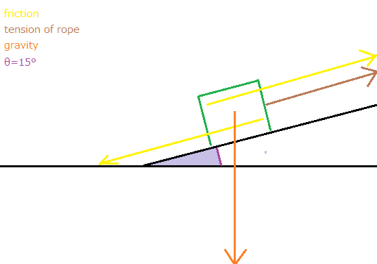

"A 68 kg crate is dragged across a floor by pulling on a rope attached to the crate and inclined 15° above the horizontal. (a) If the coefficient of static friction is 0.50, what minimum force magnitude is required from the rope to start the crate moving? (b) If μk = 0.35, what is the magnitude of the initial acceleration of the crate?"

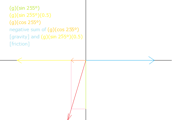

##F_g=(cos255°)(9.8\frac{m}{s^2})(68kg)=-172.48N##
##F_N=(sin255°)(9.8\frac{m}{s^2})(68kg)=-643.69N##
##f_s=(-643.69N)(0.5)=-321.84N##
But I know this isn't all that is needed to make the block go up. I have to add the difference between the gravitational force and friction, plus the friction, going up, to yield the force to pull the block up. But when I do this, the numbers do not match.
Why does your diagram show friction going both ways?
Edit: as in the other thread, you have created an unknown force called Fg but not defined it. We cannot check whether your equations are right if you do not state what the variables represent.
Because there's friction when the block goes up and goes down.
It's gravity, relative to the block's axes.
It will not do both at once. Draw each diagram for a specific context. In this case, I don't see any part of the question where the block will be sliding down.
Ok, but that's still ambiguous. Do you mean parallel to the slope or normal to it?
It's 255° from the direction of its travel.

I just reread the question and realized your diagram is quite wrong.
The floor is level. The rope is at 15 degrees.
Thank you for this insight. Let F = magnitude of the force pulling the block at a 15° angle. I know someone already did this, but it got deleted. Anyway, I want to show my process. This will be the last physics problem I do until the fall. Self-studying just isn't working for me. I get too frustrated and it messes up my mood. It's not good for my health. Thanks, guys, for being so patient with me when I've been in such a pissy mood. Anyway, here's how I did the problem. I expressed ##f_s## in terms of ##-(a)(68kg)(cos15°) = F_x## since the latter opposes the former, and vice versa. Then I express friction as such:
