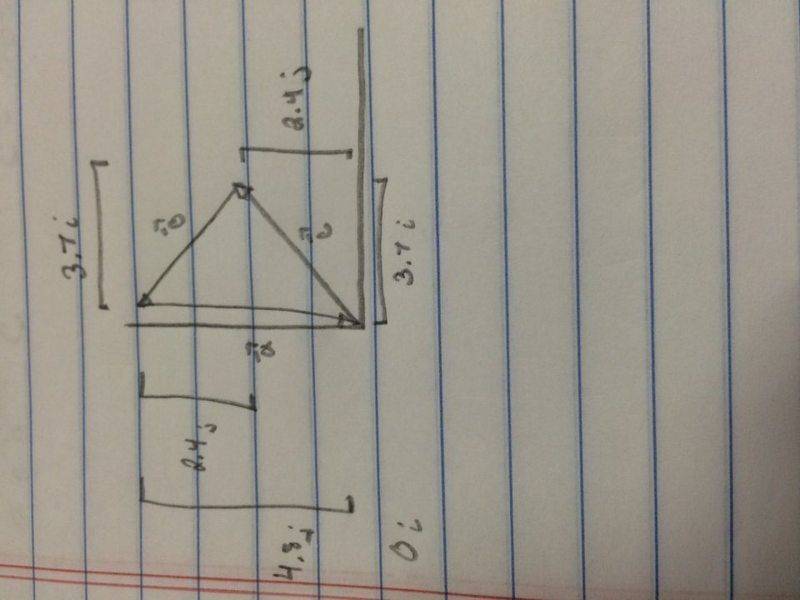

If vector B is added to vector C = 3.7i + 2.4j, the result is a vector in the positive direction of the y axis, with a magnitude equal to that of vector C. What is the magnitude of vector B?
sqroot(a^2x+a^2y) = a
My line of reasoning: since the magnitude of vector B is equal to the magnitude of vector C, then finding the magnitude of vector C using the given components would yield the magnitude of vector B.
How I went about solving the problem:
I used 3.7i as the x component of C and 2.4j as the Y component, then plugged each component into the following formula: c = sqroot(c2x+c2y). I received an answer of 4.4 but it has been marked as incorrect.
Please let me know why my reasoning is incorrect (I don't need the answer).
Hello Cada, welcome to PF :smile: !
Did you make a drawing of the situation ?
Hi,
Thanks for replying. No, I had not created an illustration of the situation at the time since I did not believe it would be necessary for this question.
I created one just now but I still do not see how it will help yield the magnitude of vector C.
Here is the drawing: http://i60.tinypic.com/2zrf6og.jpg
If the x component of the resultant is equal to zero, what does the x component of B have to be?
Chet
Hello,
Apologies.. I am reading the question incorrectly therefore assuming that the magnitude of vector B is equal to that of vector C when this is not the case.
I will give this another go - thank you for suggesting to draw this and helping.
Dear Cad,
In the picture it is hard to imagine you made the magnitude of ##\vec a## equal to the magnitude of ##\vec c##. -- Ah, you've got it! See that making a picture helps out ?
