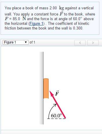

the main question asks: "If the book is initially at rest, what is its speed after it has traveled 0.400 m up the wall?"
∑F = m*a
vf2 = vi2 + 2 * a * d , when initial velocity is 0.
So here's my free body diagram:
and out of that FBD I got these equations:
∑Fx=N−Fcos(60)=0
∑Fy=fk+Fsin(60)=ma
I know that fk=μ(Fcos(60)) = μN
Should i solve for the acceleration and then plug it in the kinematics equation to solve for final velocity? And are my equations and FBD right?

The book is moving upward. Shouldn't the frictional force be downward then?
Oh okay so Fsin60 - mg - fk then? I forgot to add the mg on my equation up there.
Right.
cnh1995 said:
Right.
Ohh okay i didn't catch the "up" part on the question. So i can solve for acceleration now then given that equation?
Yes. And then plug it in the kinematic equation
Awesome. I did that and i got the right answer. Thanks a lot! :)
