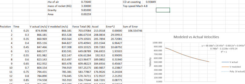

ok, i want to try out your method. I have the burnout (coasting) velocity, times, and altitudes from the sensor data at this stage. What are you meaning by "us velocity as a function of height" ? do you mean v(h)=h/t
if its a different equation, i do not remember all of them from my physics class :)

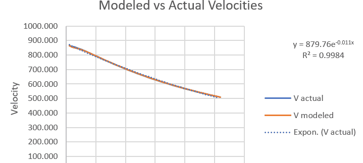

ok, great. now, how do we account for the Cd (drag coef) in the equation? that is one of the things i am wanting to solve for is that. I know that rockets have a Cd of 0.75, BUT thats not always true. My current rocket is 0.35 for its Cd. So my goal is to find TV and then use that to calculate the Cd
erobz said:
Ok. What we can calculate on the way up, we can use on the way down under the assumption it will result in a higher terminal velocity than the rocket would actually fall.
First thing you should do is lose the polynomial, and find an exponential trendline. This is because it is an exponential equation which solves the relationship below describing flight from burnout to apogee. $$ m \frac{dv}{dt} = - ( mg + \beta v^2)$$
Well be able to go straight to terminal velocity from the data.

perfect. how do we do this? do you need a pic of the data? Also, give me about 20 minutes to get to lab, just got off the train.
Thanks a mill for the help
Select trendline by left click. then right click on the trendline, go to format trendline, and select exponential.
The numbers in your table don't look right. To get to the velocity you claim in a quarter second requires an acceleration of 350 g's. That's a lot. That's a ton of force on your seven pound rocket.
Then for the rest of the powered phase, the acceleration is of order 200 in some units - but the rocket isn't getting any faster.
What I now notice about the data, is that if this is from burnout to apogee, then we have a problem. Where is ##v=0##? The graph stops at ##500 \rm{m/s}## :bugeye:
new trendline
  • #34
LT72884 said:
new trendline
Ok, but something is a miss here. Apogee velocity is zero. You did say this was data from burnout to apogee?
correct. i have the data from launch to apogee. I selected the data from when velocity hits its max, then begins to drop toward 0. roughly at 3 seconds after launch is when this happens.
at 20,751.7 feet, the velocity is -0.7 ft/sec meaning the rocket is falling. Thats where my data ends haha.
Looking up the aerotech L1030 motor, its burn time is 2.8 seconds,
