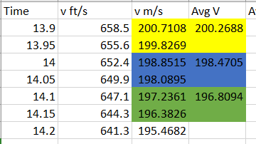

Then why is it still accelerating at 200 units?
  • #38

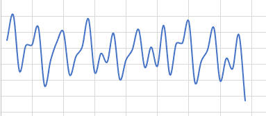

Also, I probably jumped the gun on pulling terminal velocity right out of the graph. Its exponential, but its a complicated exponential. Sorry to get your hopes up. its looks like a bit of a struggle is ahead.

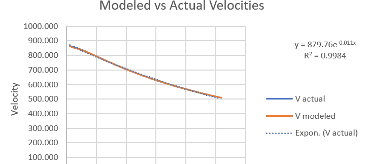

thats ok. This is a complicated project for sure. My goal is to make a "virtual wind tunnel" sort of speak. This is for my capstone project. We just built an active drag system for our rocket to compete is spaceport america cup, but our university has no wind tunnel haha. The standard value of 0.75 is a ROUGH number, so i am trying to find a more realistic number.
Using openrocket software, the number should be 0.62 for the drag coef. so i am really close. Openrocket uses a runge-kuta itteration method and since i do not know how to program, i am using excel and the solver feature to take my intial guess and then solve based on the data. you can see how close i was able to get the modeled data to match my actual

Step 1 present the proper data. We need data after burnout in the vicinity of apogee. I suspect the terminal velocity is going to be much lower than the burnout velocity. So data around burnout is not good data for this, we need data closer to the speed that it will be falling...closer to near apogee speeds than burnout speeds. Can you present the data from when the rocket is traveling at 100 m/s onward to apogee?

Yeah, if they could get fall data directly that would be best. But I'm suspecting they don't want to obliterate their rocket.

Here is from burnout to apogee. its alot of numbers, let me see if i can attach it as a file first

  • #48
i did not see this reply, yes i can do this real quick.. this should be much better.
  • time and velocity from burnout to apogee.xlsx
  • #49

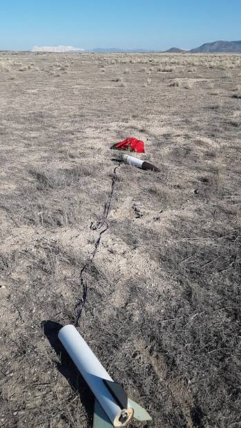

the chute/shoot doesnt deploy for 24.6 seconds and apogee hits at 27.1 seconds. So the chute pops right before apogee. The chute is below the nose cone.
This image was a test launch to 1 mile
15 foot shock cord, 5 foot chute
i can get permission to allow a rocket to go ballistic but it has to be a smaller rocket haha.

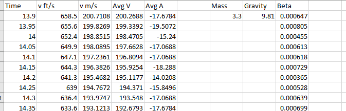

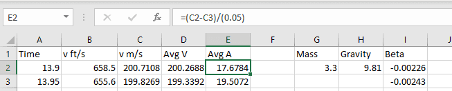

So you plug in the quadratic drag force to equation and divide through by ##m## and you will arrive at what I have written in post #40.
After that take a moment to study it and identify all the data that you have, or could calculate from the data you captured.
