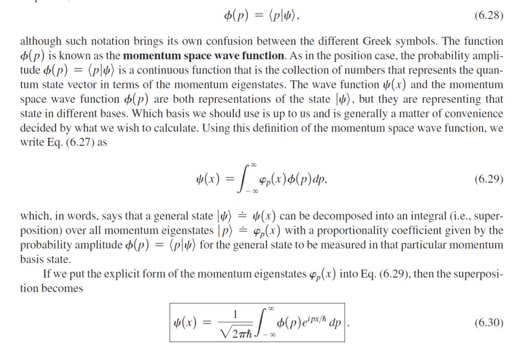

Hmm but my book says the following:

But I thought equation 6.29 and 6.30 in the picture is in momentum space? Also, I do want to use momentum space.

There is nothing in my book that provides a momentum space wave function with a function of only p. All the equations my books has, for the momentum space, has it with a function of x in it so in that respects I don't know what the momentum space wave function should be.

That's not true. Equation 6.28 from the extract you quoted is:
$$\phi(p) = \langle p|\psi \rangle$$
That's the momentum-space wave-function for state ##\psi##. And this function appears in the Fourier transforms.
PS McIntyre uses ##\psi## for the state and ##\psi(x)## for the position space wave-function, which suggests a more fundamental relationship between the state and position space. This is misleading, as ##\phi(p)## is just as valid a representation of the state ##\psi##.
PS McIntyre uses##\psi## for the state and ##\psi(x)## for the position space wave-function, which suggests a more fundamental relationship between the state and position space. This is misleading, as ##\phi(p)## is just as valid a representation of the state ##\psi##.
Hmm but I quoted earlier that ##\phi(p) = \frac{1}{\sqrt{2\pi\hbar}}\int\psi(x)e^{-ipx/\hbar}dx## which I know to be the Fourier transform between the momentum space and position space so why isn't that not a momentum space wave function but 6.28 is?
