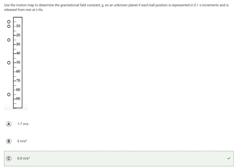

Finding value of g given a motion map
In summary, determining the value of g using a motion map involves analyzing the motion of an object under the influence of gravity. By examining the object's position, velocity, and acceleration at different time intervals on the motion map, one can calculate the gravitational acceleration (g) by applying kinematic equations and considering the effects of forces acting on the object. This process requires an understanding of the object's trajectory and the relationship between its motion and gravitational pull.
Kashmir
468
74
All the equations of motion for constant acceleration such as
v=u+at.
s=ut+1/2 at^2
I tried using all equations of motion but couldn't get the correct answer.
Any hint would greatly help. I've tried doing this for two days now!

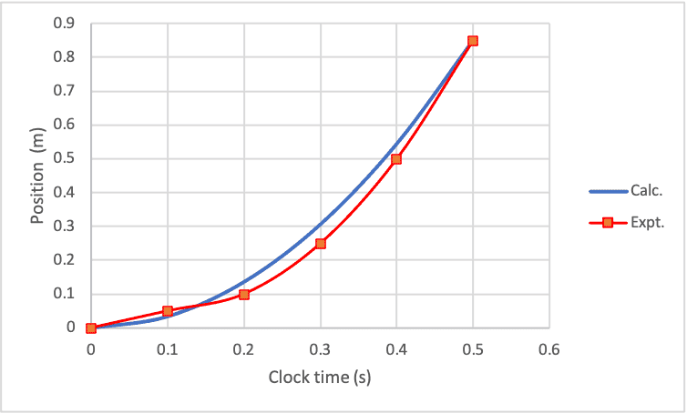

The data does not correspond to a body released from rest at time zero. It corresponds to a body released from z = 10 at time zero, and having an initial upward velocity of 100.
The original question (image in Post #1) specifically states "...released from rest at t=0s". I think the question is ok, however, the diagram appears to be inaccurately drawn.

No way. I had my graphics package fit a quadratic to s vs t, and the equation it delivered was $$s=10-100t+500 t^2$$This is an exact fit to the data provided.
I don't disagree with your analysis.
The problem is the inconsistent question/diagram. The question explicitly states that the ball is released from rest (and we assume acceleration is constant). But the diagram provided is inconsistent with this (as your analysis clearly shows).
I believe the intention of the author of the question was this:
The ball is released from rest at t=0 from the top of the ruler marked in cm.
The lowest position of the ball is to be used to find the acceleration (which gives the indicated answer of 6.8m/s²).
Unfortunately, the intermediate positions of the ball shown on the diagram do not then match their expected positions. (This could conceivably simply be due to careless drawing.)
Well, that’s my interpretation!

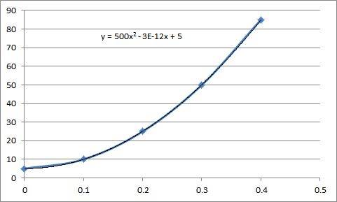

I pick option b.
It looks like the data satisfy very well a free fall with g=10 m/s, starting from rest at the position 5cm on the ruler, a shown in the figure.
The distance travelled during each 0.1 s intervals are:
5 cm during the first second
15 cm during the second second (3 x 5)
25 cm during the third second (5 x 5)
35 cm during the fourth secons (7 x 5).
A second order polynomial fit of the data set (positions of 5, 10, 25, 50, 85) versus time in 0.1 increments starting with zero gives a fit with 500 1000##cm/s^2## for acceleration. The linear term is of the order of ##10^{-12}## and is just error from the fitting algorithm.
Edit. Corrected the value of 500 to 1000 after @Chestermiller's observation.

500 is wrong. The 2nd derivative of y with respect to x is 1000.

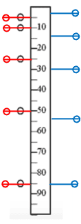

Aha! I took the start as t=0, s=0, v=0. But it looks like the intention is that it should be t=0, s=5cm, v=0.
That leads to a value for g which is consistent with the ball positions on the diagram.
So g=10m/s² though this is not on the list of available choices. Probably an error in the choice-list.
Let's assume that the object is released at ##t =0, s = 0, v = 0##. After ##0.5s## it has fallen ##0.85m##. The average speed over this time is ##1.7 m/s##, so the final speed is ##3.4 m/s##. That gives an acceleration of ##6.8 m/s^2##.
The penultimate data gives a fall of ##0.5m## after ##0.4s##, giving an acceleration of ##6.25 m/s^2##. Presumably this is to be taken as less accurate than the final data. As are the other previous data.
Likes Lnewqban, MatinSAR and nasu

If it starts at t=0 at s=0 and it's at s=5 after 0.1 s and then it's at s=10 after another 0.1 s, the motion would have zero acceleration over this interval.
Likes MatinSAR
PeroK said:
Yes, the initial position is not shown.
Then what is the first position shown? At what time from t=0?
The first position is at approx ##0.05m## at ##t = 0.1s##.
Likes MatinSAR
So it moved 5 cm in 0.1 s and then again 5 cm (from 5 to 10) in another 0.1s. How can this be in a free fall?
Experimental error!
PS note that the positions appear to be to the nearest ##5cm##.

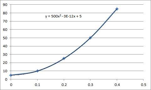

I too got $$s=5+500t^2$$ for a fit of position and time pairs. If I compare with the SUVAT equation $$s=s_0+v_0\,t+\frac{1}{2}a\,t^2,$$ I deduce that
  1. ##s_0=5## units
  2. ##v_0=0## which implies that the mass starts from rest at ##s_0##
  3. ##\frac{1}{2}a=500~##units which implies that the acceleration is 1000 units/s2.
That's what the numbers say and they don't lie. We don't know what the units on the scale are. However, if we accept that the correct answer is 6.8 m/s2, then we can calibrate the scale and say that 1 unit =6.8 mm.

2) The graph shows an object falling from ##0 cm## for ##0.5s##. The question required the answer which best fits the data (not necessarily perfectly fits the data). And, allowing for experimental error, ##g = 6.8 m/s^2## is a good fit for the data.
Likes MatinSAR and Steve4Physics
You don't need to assume what happened before the first point shown in the figure. As @kuruman shows, you can use the given points to find it from the fit. It could have been that the object had some vlocity at the first position shown but if you take this as a parameter, the best fit shows that it is zero.
But if you want to assume some error and that the motion started before the position indicated, there is no reason to assume that it started exactly 0.1 s before. If there is error, then why not in this value? Why to take the total time 0.5 s and not 0.45 or 0.55 or whatever? By taking different values of this pre-interval you can obtain all the suggested answers. Maybe the reaction time to turn on the stopwatch was so that the time before the first recorded position was 0.17 s and not 0.1 s. Then the average velocity for the 0.85 cm (assuming the scale is in cm) vill be 14.46 m/s and the acceleration 5.0 m/s 2.
I think that all agree that the problem as posed has some "problems". It may be interesting to "guess" the author's mind (rather than assume that is a mistake in the answer key) but how is this helping a student who does know the answer in advance?
It may be that there was another answer below (c) (or more), not shown in the image cut, and there was bug in the software. What if there was a choice (d) 9.8 m/s 2?
We found this case (the wrong answer indicated as correct) several time in the online packages used for tests during the look-up. It is not even a mistale of the author of the tests but just some programming bug. It may be useful if the OP indicates the source. But I don't think he is interested any more.
Likes MatinSAR
We can use the model to calculate the positions at the "measured" times. These are summarized in the Table below.
Time (s)​
Expt. Position (m)​
Calc. Position (m)​
0​
N.A.​
0​
0.1​
0.05​
0.03​
0.2​
0.10​
0.14​
0.3​
0.25​
0.30​
0.4​
0.50​
0.54​
0.5​
0.85​
0.85​
The discrepancy between the "experimental" values and the calculated values has been attributed to "experimental" error. I doubt that there ever was an experiment that generated these data, but I will play along. I will superimpose on OP's figure the predictions of the model A where the acceleration is ##a_A=10~\text{m/s}^2## and the object starts from rest at the 0.05 m mark (red circles) and model B where the position are calculated using an acceleration ##a_B=6.8~\text{m/s}^2## and the object starts from rest at the 0 m mark (blue circles.)
A more conventional presentation of model B is shown below. The "experimental" data are shown as discrete points connected with a smoothed line and the calculation is shown as a solid line. It looks like the assumption that the initial position of the object is zero throws the parabola out of kilter. This is no random variation due to experimental uncertainty.
Let the reader decide which is the best analysis of the data: one that yields a value for the constant acceleration that makes assumptions about the initial conditions or one that does not need such assumptions.
