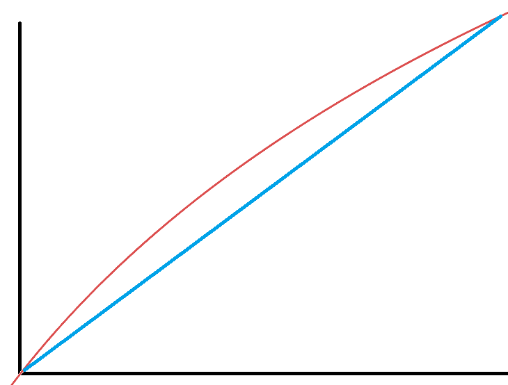

  • #77
Because of its convexity/concavity
we already know that linear velocity won't work
Likes erobz

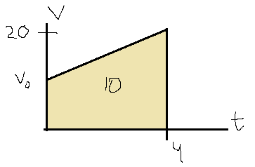

  • #83
malawi_glenn said:
now the only way to get that area to become 10 is if v0 is negative, because the picture you posted shows the minimal area with v0≥0
You can come up with any kind of v(t) for your problem as long as the graph is above the horisontal axis between 0 < t < 4, it has v(4) = 20, and the area is equal to 10.
Is there an easy way of determining what the v0 should be for a particular curve, such that the area actually is 10? In your case above it's not actually possible given the shape.
I am trying to solve this problem programmatically so I see there being two challenges:
  1. Constructing a curve in which area underneath can actually equal 10.
  2. Setting the v0 that actually satisfies the area.
How do I decide which one to do first? As mentioned, I cannot do this manually as the "s", "v", "t" values will be different for different orbits, so manually defining a velocity profile that works is not viable. I need a programmatic way to shape the curve with the correct v0, which works for any number of "s", "v", "t" automatically.
I'm sure you guys have probably already given the answer to this but I just haven't recognised it yet. Have I missed something?

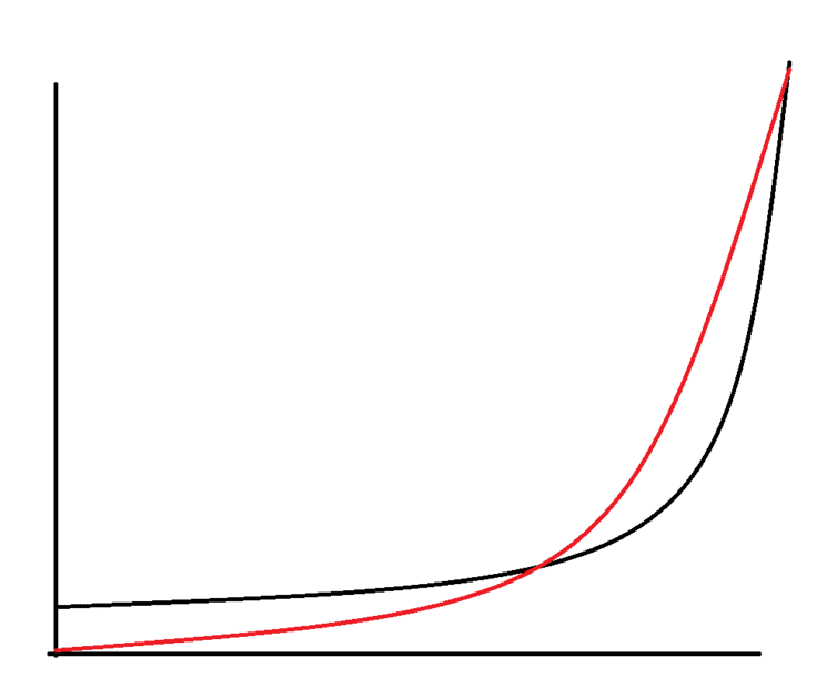

  • #86
This should illustrate the problem with having a non-zero v0
These velocity profiles have the same final speed and the particle will cover the same distance (well, the picture here should be taken with a grain of salt, I have not actually measured their areas but it is just for illustrational purposes)
The particle with higher v0 has to experience a much larger acceleration at the end of its trajectory.
Likes Jack7

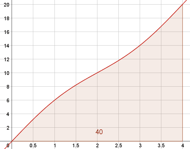

  • #88
You could define piece-wise constant accelerations over several time-intervals.
Here is an example I made in Geogebra, by inserting 6 points and varying their position (keepin the origin and (4,20) fixed). Then use the polygon tool and displaying its area
You can adjust until you get something that looks reasonable for you. Also you can use more points to determine the shape.
In this, crude, example - we see that in the last 0.5 seconds the speed will increase from 4 to 20.
And the ratio of distance traveled is ~54%
In the last second, the speed will increase from ~2.5 to 20 m/s and the ratio of distance traveled is ~70%
Likes Jack7
