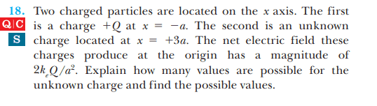

For this problem,

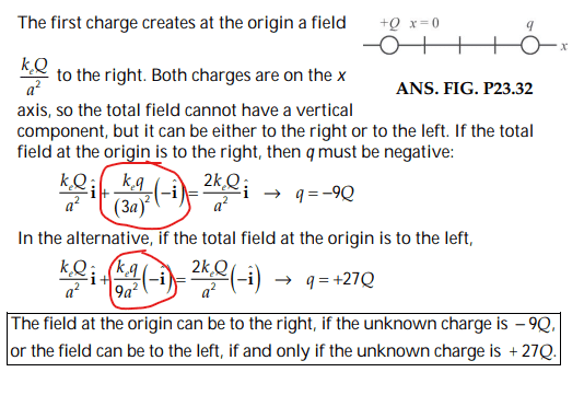

The solution is,
However, why did they assume that the electric field produced by charge q is always pointing to the left at the origin?
Many thanks!

For this problem,

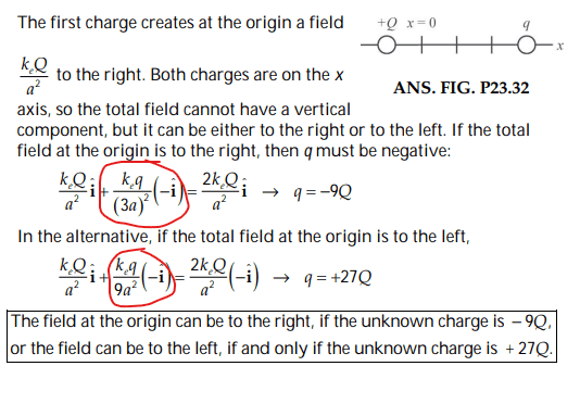

The solution is,
Many thanks!
They are not assuming that the electric field is pointing to the left.
Think about it.
If ##q## is a positive charge, then indeed, the electric field at the origin, due to ##q##, is to the left (negative).
What if ##q## is negative? Then you have a negative number multiplied by a negative number. In what direction is the electric field, due to ##q##, pointing in this case?

Thank you for your reply @SammyS !
If ##q## is negative, then the electric field due to the charge will be pointing to the right as a positive test charge would be attracted to the negative charge.
