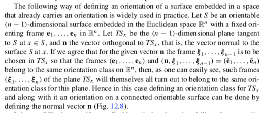

But now, I'd like to go one step further and understand why, in addition to everything I've said above, my book also adds:
My doubt is: if every time I fix a normal ## \mathbf {n} ##, I force the other ##n-1 ## vectors ## (\xi_1, ..., \xi_{n-1}) ## (generators of the tangent space) to be such that the frame ## F (\mathbf {n}) = (\mathbf {n}, \xi_1, ..., \xi_ {n-1}) ## is in the same equivalence class as the frame ## F_0 = (\mathbf {e} _1, ..., \mathbf {e} _ {n}) ## (i.e., ## \det M_ {F_0 \to F (\mathbf {n})}> 0 ##, with ## M_ {F_0 \to F (\mathbf {n})} ## frame transition matrix), then if I take any two normals ## \mathbf {n} _1 ## and ## \mathbf {n} _2 ##, I will always have that:
##\det M_{F(\mathbf{n}_2)\to F(\mathbf{n}_2)}=\det M_{F(\mathbf{n}_2)\to F_0}\cdot \det M_{F_0\to F(\mathbf{n}_1)}=\frac{\det M_{F_0\to F(\mathbf{n}_1)}}{\det M_{F_0\to F(\mathbf{n}_2)}}>0##
by construction, that is, I will always fix only one of the possible orientations of ## S ##.
I'm not quite sure where your question is. If we have an embedded surface, then there are two possibilities for the normal vector: outward bound, which is the standard choice, or inward bound, right hand rule versus left hand rule.
My question concerns the procedure that Zorich described in the annex to the previous message. I said that in my opinion that procedure (followed to the letter as described) produces frames always belonging to the same equivalence class, which instead one wants to avoid (I guess). I think instead that one wants to find a procedure such that, fixed a normal, a frame comes out in an equivalence class, while changing towards the normal a frame in the opposite equivalence class comes out.
