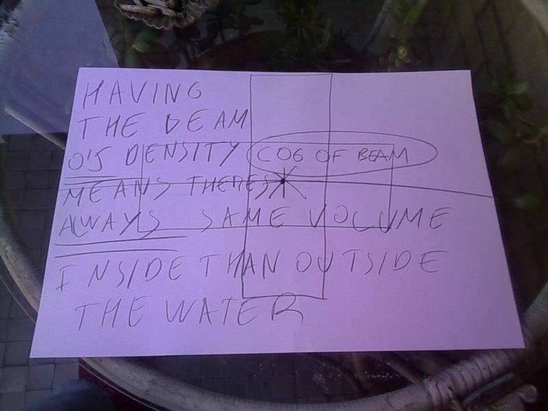

theres one beam of wood of density 0.5 floating on water of density one
the beam is vertical and i assume it will go to horizontality
this force that moved the wood beam implies a work has been done and hence potential energy has been spent
but if the beam has density 0.5 it means it has the same volume underwater than over water either horizontally or vertically hence its cog hasnt varied height and on the same manner the level of water remains in the same level with respect to the cog of the beam of wood
so from where comes the potential gravitational energy that has applied the work on the wood to move it from vertically floating to horizontally floating
my conclusion from this thought experiment is that a 0.5 density beam will float indiferently horizontally or vertically to kep conservation of energy true
is this correct?

well i don't see that what you say, check this diagram, the cog of the beam remains in same position weather the beam floats vertically or horizontally:

The beam will not float vertically that way. It will fall over into the horizontal position.
im not very sure of that if the cog of the beam doesn't move nor the level of water moves
whay does it fall then? how has the beam spent potential energy as to move naturally?
maybe its imposible to get an exact 0.5 density and the slightest offset could make the beam lean?

Floating horizontally or floating vertically, the center of mass of the beam does not change. It is located exactly at the surface of the water. Half of the beam is submerged and half floating either way.
However, the center of mass of the water is displaced downward when the beam rotates to horizontal. The hole in the water where the beam resides has moved upward and water has moved downward to fill in that space.

Consider the torque from the buoyant force around the CoM for small perturbations of those two extremes.

That's right. A vertical orientation is an unstable position for the beam to be in, as even the slightest force will disturb it and send it rotating to the horizontal position.

You are missing the point. The center of gravity of the beam is utterly irrelevant. The center of gravity of the water is the bit that matters.
Likes farolero
oh i see so potential energy to move the vertical beams comes from the water lowering its cog
thanks a lot i wouldn't have seen it without help
