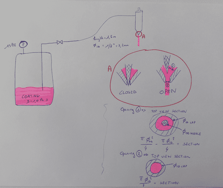

The coating is stored in a pressure tank, which we put on an overpressure of 15psi.
From the pressure tank to the coating dispensing valve we use a flexible hose with an inner diameter of 1/8" (3,2mm).
The dispensing valve is a standard dispensing valve with a needle actuator which opens a certain set distance, creating an opening for the coating to spray out of the dispensing valve.
To calculate the flowrate (grams/volume per minute), I think I should use the Hagen-Poiseuille equation to calculate the pressure drop over the 1,5m flexible hose.
But how should I calculate the flow rate out of the dispensing valve?
Due to the angled needle actuator and the angled spray cap the opening is not a constant over a certain distance, so I believe the Hagen-Poiseuille equation doesn't apply. Maybe I should look into the Bernoulli equation?
Here's a quick sketch of the set up:

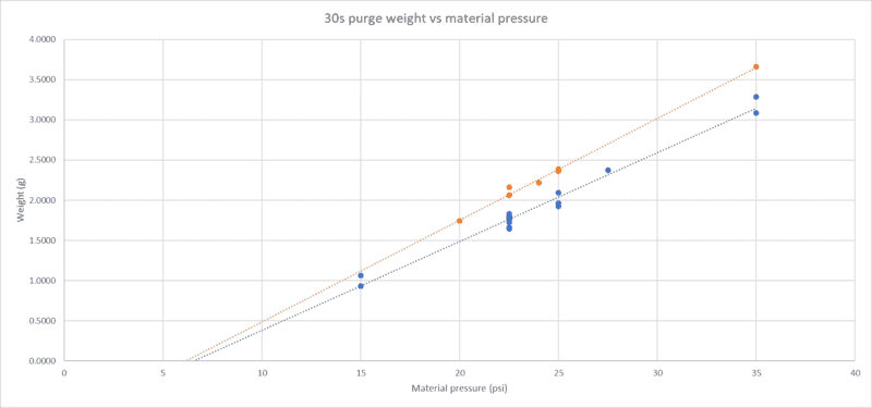

I don't understand this graph. Is this done with an offline test to get higher pressure drops? Why is the flow rate zero when the pressure drop is 7 psi? If you have a rough estimate of the viscosity, what do you predict for the pressure drop/flow rate relationship of the hose alone?

The graph is the relationship between the pressure we put on the tank and the flow rate (the weight out of the dispensing valve in 30 seconds). The pressure drop of 7psi is indeed the pressure drop over the hoses from the tank to the dispensing valve. If I calculate this theoretically with Hagen Poiseuille I get very close to the 7psi, so that makes sense to me.
The blue graph is the test we did on a monday a while back, so we put the pressure of the tank on different pressures and measured the flow rate. On tuesday we did the same, kept everything the same, but the graph has a different gradient.
Why that is, is what I'm trying to figure out.
My best guess before posting on this forum was viscosity change (due to temperature, slow precuring in material supply, ...).
That's why I'm wondering if there should be a theoretical relationship between the flow rate and the viscosity, and if so is it a linear behavior and on what theory is it based?
Thanks for the help!
Something is inconsistent. There must be flow to generate a differential pressure across the hose?
EDIT: unless you have a ##7 \, \rm{psi}## static elevation head, but you would read a ##0 \, \rm{psi}## at the nozzle in that case.
You get 7 psi for a flow rate of zero? Not likely. In these calculations, what value of viscosity did you use?

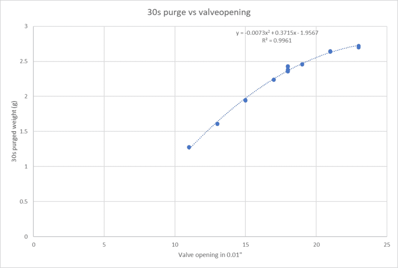

Are you doing tests by varying the valve opening (measured by stem height)?

1. The graphs are the actual results of a test, so by extrapolation of the trendline I get 7psi which than indicates the pressure drop. Or is this not correct? If not, why not?

3. Here are the results of a varying valve opening versus the flow rate.

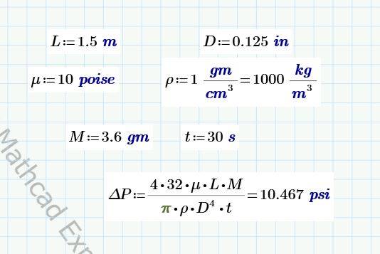

For your hose, the Reynolds number is give by $$Re=\frac{4\dot{m}}{\pi D \mu}$$where ##\dot{m}## is the mass flow rate, D is the inside diameter, and ##\mu ## is the coating viscosity. For a mass flow rate of 0.12 gm/sec (3.6 gm in 30 seconds), a hose diameter of 0.32 cm, and a viscosity of 10 Poise (1.0 Pa-s), the Reynolds number is $$Re=\frac{(4)(0.12)}{\pi(0.32)(10)}=0.048$$According to this, the flow in the hose should be Laminar under all test conditions.
The shear rate at the wall at this flow rate (assuming a density of 1 gm/cc) will be given by $$\gamma=\frac{32Q}{\pi D^3}=\frac{(32)(0.12)}{\pi (0.32)^3}=37\ sec^{-1}$$The shear stress at the wall would then be $$\tau=\mu \gamma=(37)(10)=370\ dynes/cm^2$$The pressure drop due to flow in the hose would then be $$\Delta p=\frac{4L}{D}\tau=\frac{4(150)}{0.32}\tau=693750\ dynes/cm^2=10.1\ psi$$So, if M is the cumulative mass of coating in 30 seconds, the pressure drop in the hose should be given by $$\Delta p=\frac{m}{3.6}(10.1)=2.8 M\ psi$$

I'm getting ##10.47 \, \rm{psi}## using mathcad with the formula I quoted above for the hose.

It must be due to my rounding off the diameter to 0.32 cm vs 0.3175 cm
