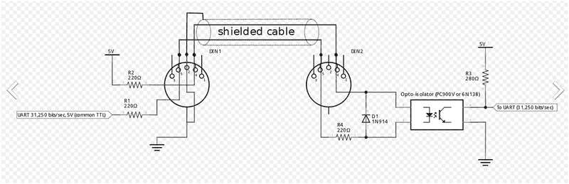

Old-style MIDI supports integer values from 0 to 127 from one controller. Information is sent when a value changes. The information consists of a controller value (breath control is generally 2) and the value. Most breath controllers I know measure pressure. If you were to add a bite sensor, it would be coded using some other controller value; the bite strength would still be from 0 to 127. But, as I said, let's focus just on the breath control.
Let me add that you don't need to worry about what I'll do with this input. MIDI controllers can be mapped to anything. If I have two virtual MIDI instruments, I might map the breath controller to different characteristics. When one designs a controller, one doesn't worry about what it will be used to control.

I only skimmed the MIDI Wikipedia article, but it looks like you need your device to be pretty low power unless you get power from somewhere else, no?
Likes FluidDroog
Are commenting on the hot-wire anemometer idea? Does it need a lot of power?
Most MIDI devices these days have USB connections or have MIDI and USB connections. But since I'm talking about creating a new type of breath controller, I could get power from anywhere. Ideally, one would want it to be capable of working either using USB power or household batteries.
