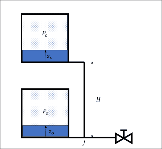

Lets approximate that the flow is steady in each branch over some period of time i.e. in each branch the rate of change in flow in that branch is not changing strongly in time. Also ignore viscous effects in the transmission lines. Furthermore, the top tank is open to atmosphere as a simplified problem, and the total flowrate ##Q_T## is to remain constant in time.
Bernoulli's Implies:
$$ \frac{P(z_1)}{\rho g } + z_1 + \frac{\dot z_1^2}{2g} = \frac{P_{atm}}{\rho g} + z_2 + H + \frac{\dot z_2^2}{2g}$$
Continuity Implies:
$$ Q_T = A \left( \dot z_1 + \dot z_2\right) \implies \dot z_2 = \frac{Q_T}{A} -\dot z_1$$
From integrating continuity we find that:
$$ z_2 = z_{2_o} + \int \left( \frac{Q_T}{A} -\dot z_1 \right) dt $$
Lets eliminate ##z_2, \dot z_2##:
$$ \frac{P(z_1)}{\rho g } + z_1 + \frac{\dot z_1^2}{2g} = \frac{P_{atm}}{\rho g}+ z_{2_o} + \int \left( \frac{Q_T}{A} -\dot z_1 \right) dt + H + \frac{\left( \frac{Q_T}{A} -\dot z_1 \right)^2}{2g}$$
Now, take the derivative w.r.t time ##t##, to eliminate that integral from the equation:
$$ \frac{1}{\rho g}\frac{dP(z_1)}{dz_1 } \dot z_1 + \dot z_1 + \frac{2\dot z_1 \ddot z_1}{2g} = \cancel{\frac{P_{atm}}{\rho g}}^0+ \cancel{z_{2_o} }^0+ \frac{Q_T}{A} -\dot z_1 + \cancel{H}^0 - \frac{2 \left( \frac{Q_T}{A} -\dot z_1 \right) \ddot z_1}{2g}$$
Where ##P(z_1)## is found from the ideal gas law ( isothermal ):
$$ P(z_1) = \frac{P_o V_o}{V_o - A z_1} $$
$$ \frac{1}{\rho g}\frac{dP(z_1)}{dz_1 } \dot z_1 + 2\dot z_1- \frac{Q_T}{A} + \frac{Q_T}{gA} \ddot z_1 = 0 $$
Given the form of this simplified equation, and the many assumptions that don't strictly hold for all time. I think active control ( like @Baluncore proposes ), or scaled experimentation are going to be desirable approach (maybe it looks worse than it is in actuality). If you try to account for the fact that the flowrates are actually not steady, the upper tank builds pressure, and transmission losses it only gets mathematically worse as far as I can tell.

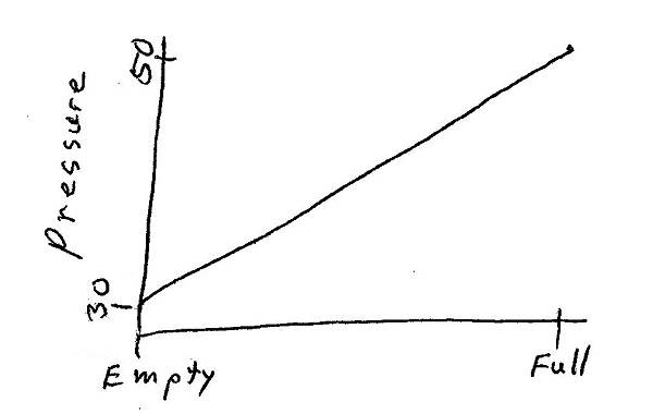

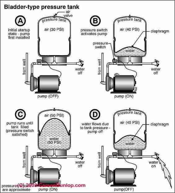

Hankelec said:
Kick-in pressure equals 30 psi so empty tank will be pressurized to 28 psi. Kick-out pressure is 50 psi.
When the tanks are empty, the pressure is 28 PSI.
At kick-in, the pressure in a tank is 30 PSI, and the tank is almost empty.
At kick-out, the pressure in a tank is 50 PSI, and the tank is as full as it gets.
The pressure in a tank is proportional to the amount of water in that tank as shown in the graph below:
Five feet of head pressure difference between the two tanks is 2.2 PSI. The pressure difference between tank empty and tank full is 20 PSI, so the 2.2 PSI of pressure difference is 2.2/20 = 11% of the tank capacity. The bottom tank will be 11% full before the top tank starts to fill, then there will be equal flow into both tanks until the bottom tank is full at 50 PSI. The top tank will be 89% full at that point because the pressure in it will be 47.8 PSI.
In the real world, these differences are so small as to be not noticeable.
Likes Hankelec, Juanda and hutchphd

Hankelec said:
When I came upon this project, the bottom tank was at least 90% full and the top tank virtually empty.
This does not agree with the tank theory shown in Post #13. If the air bladder of a tank was properly precharged to 28 PSI, then a full tank must be at about 50 PSI, and and empty tank about 30 PSI. But both tanks are connected with a pipe, so they must be at the same pressure. Something is not right, which raises some questions:
1) How do you know the water level in each tank?
2) Did you check the precharge pressure in each tank with the system empty?
3) What was the pressure in each tank at the time mentioned in Post #14? Measured at the air filler.
4) Have you confirmed that each tank has a properly functioning bladder? Bladders can fail by leaking or sticking.

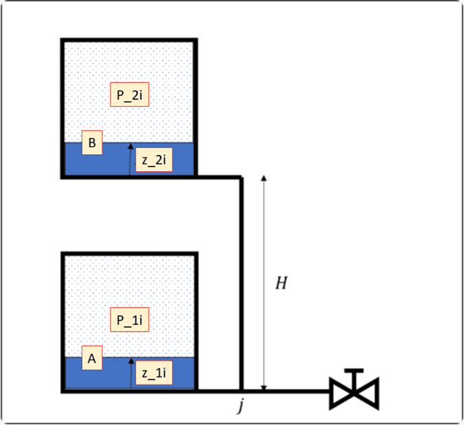

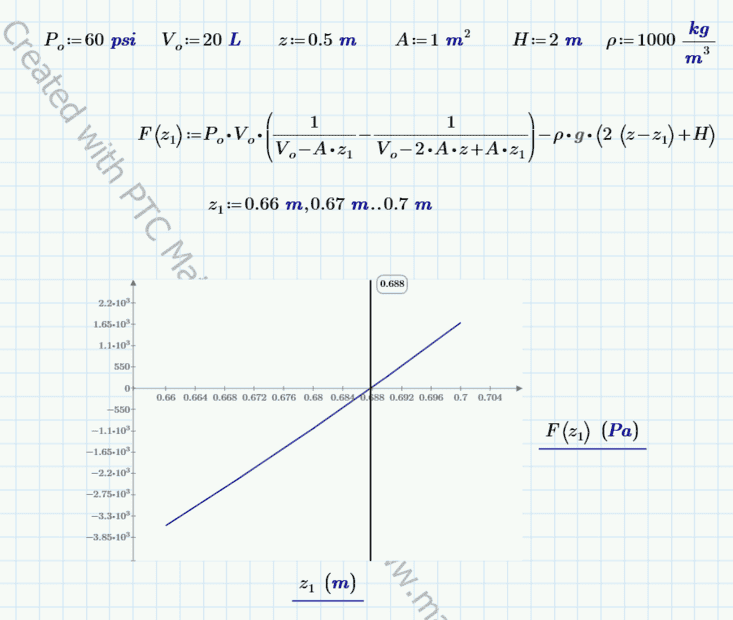

I used work-energy to find the equilibrium state of two identical tanks with identical initial conditions:
##P_o## is the initial pressure inside each tank
##V_o## is the initial volume of ideal gas at ##P_o## in each tank
##z## is the initial height of water in each tank relative to the bottom of each tank.
##A## is the cross-sectional area
##H## is the elevation difference of the tanks
##\rho## the density of water
At time ##t=0## the hypothetical valve isolating them is opened and the system is allowed to establish equilibrium. For the arbitrary parameters I chose this resulted in the lower tank ( beginning at ##z = 0.5 \rm{m}## ) having a final height of nearly ##0.7 \rm{m}##, and the upper ( also beginning at ##z = 0.5 \rm{m}## ) having a final height of ##0.3 \rm{m}##.
The intersection of ##F(z_1)## with the abscissa is the final height for ##z_1##.
If you give the parameters for your actual system of tanks, I can check what the theoretical final state is?

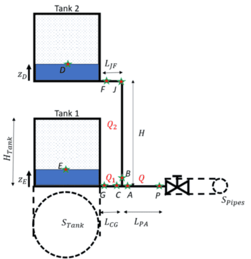

Just to be more descriptive about the method, the system is taken to be the mass of fluid in each tank. The pressure in each tank is responsible for the external work on the system:
Referencing the diagram in #11, defining ##\uparrow^+##, apply Work -Energy:
$$ -A \left( \int P(z_1)dz_1 + \int P(z_2)dz_2 \right) = \rho A g z_2 ( H+\frac{z_2}{2} ) - \rho A g z ( H+\frac{z}{2} ) + \frac{1}{2} \rho A g z_1^2 - \frac{1}{2} \rho A g z^2 $$
Expanding the RHS:
$$ -A \left( \int P(z_1)dz_1 + \int P(z_2)dz_2 \right) = \rho A g \left( H z_2 + \frac{z_2^2}{2} + \frac{z_1^2}{2} - \overbrace{ z \left( H+ \frac{z}{2} \right) + \frac{z^2}{2} }^{\text{const.}} \right) $$
From Continuity:
$$A( z- z_2) = A( z_1-z )$$
$$ \implies z_2 = 2 z - z_1 $$
$$ \implies dz_2 = -dz_1 $$
Substitute to get everything in terms of ##z_1##
$$ -A \left( \int P(z_1) dz_1 - \int P( 2 z - z_1 ) dz_1 \right) = \rho A g \left( H (2 z - z_1)+ \frac{ (2 z - z_1)^2}{2} + \frac{z_1^2}{2} - \overbrace{ z \left( H+ \frac{z}{2} \right) + \frac{z^2}{2} }^{ \text{const.}} \right) $$
Take the derivative of both sides w.r.t. ##z_1##:
$$ \frac{d}{dz_1}\left[-A \left( \int P(z_1)dz_1 - \int P( 2 z - z_1 )dz_1 \right) \right] = \frac{d}{dz_1}\left[\rho A g \left( H (2 z - z_1)+ \frac{(2 z - z_1)^2}{2} + \frac{z_1^2}{2} - \overbrace{ z \left( H+ \frac{z}{2} \right) + \frac{z^2}{2} }^{\text{const.}} \right) \right] $$
$$ \implies -A ( P(z_1) - P(2z-z_1) ) = \rho g ( -H -( 2z -z_1) + z_1) = \rho g ( 2( z_1-z) - H )$$
Dividing by the area of the tank ##A## and taking the negative of both sides:
$$ P(z_1) - P(2z -z_1 ) = \rho g (2(z-z_1)+ H ) $$
Assuming isothermal process to equilibrium (after a long time the temperature returns to ambient in each tank) we have that generally:
$$ P(x) = \frac{P_o V_o}{V_o - Ax}$$
Subbing in that result:
$$ \frac{P_o V_o}{V_o - Az_1} - \frac{P_o V_o}{V_o - 2Az + Az_1} = \rho g ( 2( z-z_1) + H ) $$
Then just pull everything to the LHS to graphically find ##z_1## which satisfies:
$$ \frac{P_o V_o}{V_o - Az_1} - \frac{P_o V_o}{V_o - 2Az + Az_1} -\rho g ( 2( z-z_1) + H ) = 0 $$

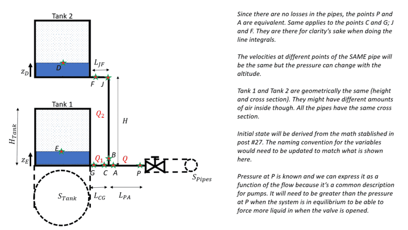

Given the unsymmetric state of equilibrium, what is the reasoning behind proposing that the tanks will receive equal flowrates in the dynamic case? It seems clear to me that there would be significant bias toward the lower tank filling at a greater rate, because that is where they are going to end up regardless. The friction present in the piping would also drive the bias further in the dynamic case.
I didn't follow the math you posted step by step so I can't argue whether it's correct or not. I'll try to revisit the thread when I get the chance to check the math. Still, I believe I can answer your question (marked in bold) at least qualitatively. I think I understood the situation when I read post #13 by @jrmichler.
I see it like this:
  1. The flow will be towards the tank with the lowest pressure at its intake because the mass flow will follow the path of least resistance.
    NOTE: I consider the intake to be the T fitting where the flow separates.
  2. The mass flow towards that tank will increase its pressure.
  3. The situation will continue until the pressure at the intake in the lowest pressure tank equalizes with the intake pressure at the other tank.
  4. At that point, the mass flow will divide equally between both tanks.
By the way, I think that implies the pressure at the tanks changes linearly with the mass flow. If that is not the case, then the mass flows will keep oscillating around the equal mass flow point repeating the described cycle (1→4). Again, I'm only tackling the qualitative aspect of this situation so I don't have the math to back that claim at the moment but I'm fairly confident about this.

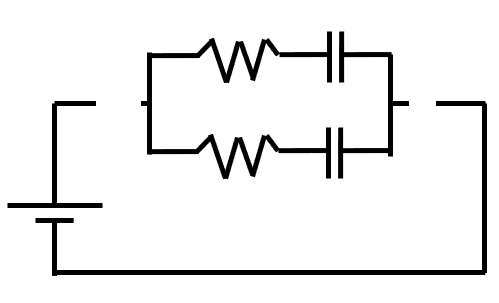

I guess a somewhat valid analogy is to imagine a simple DC circuit powered by a battery and two resistances and two condensers in parallel. Make the condensers equal but have different resistance values. In the dynamic analysis, we would see how initially most of the current flows through the smaller resistance but then the condenser charges and pushes back so more current will start flowing through the other one.
A possible error in the described cycle (1→4) is that I said ALL the fluid goes through the smallest resistance path. I'm pretty sure that doesn't happen in the electrical analogy. Only MOST of the current goes through the least resistance path so I feel like the same would happen in the fluid case although I can't really tell without doing the math.
Feel free to point out any errors in what I posted. It seems the OP had enough already and it's possible there are no truly practical applications (changes too small to be problematic or even noticeable) for what we're discussing. Still, the problem is interesting and poses a chance to learn more about this kind of system I have no experience in.
I'll try to post a diagram describing the tanks filling up and the DC circuit analogy so that it's easier to visualize what I'm seeing in my head but drawings take a time I don't have right now. Maybe I can do it before hitting the bed.
I think the effective circuit is not so straightforward as that.
At a minimum we need resistances from the pipe proportional to the current in each branch with different proportionalities representing the vicious effects. The liquid head accumulating is not a resistor, it is a gravitational capacitor, and the gas is a capacitor of different characteristics. The liquid capacitor of the upper branch is initially charged to a different value than the liquid capacitor of the lower branch. This is due to the static liquid head differential of ##H##. The gas capacitors in each branch are initially equivalent in charge. Maybe someone could figure out the necessary characteristics of each component and model it in SPICE or something. I don't have that skill.
I still don't think the branches get equal flow at any point in time, and when the feed voltage to the circuit is switched off the parallel branches which form a closed loop (having differing accumulated charge in each of the capacitors) will equilibrate.
erobz said:
If I need to clarify more let me know.
Maybe using "analogy" was taking it too far. I was just trying to show an example of something with similar behavior where previous knowledge could help to have an intuition. (I assume this kind of electrical circuit is something more common in universities than the filling tanks under study)
erobz said:
I still don't think the branches get equal flow at any point in time.
Well, they will tend to have the same flow. We know for sure at t→INF the flow will be the same in both branches because it stops in both when equilibrium is reached. It happens when the pump can't keep pushing fluid in.
The take-home message is that both branches approach that state and the tank with the lower intake pressure will approach it faster also increasing its pressure faster up to the point where they're both filling up at about the same rate because they have about the same pressure at the intake.
If you consider the DC circuit is not useful to transmit the concept I feel we should drop it altogether and focus back on the tanks. I didn't intend it to be a 1:1 translation where mathematical tools can be easily reused but a mere example of a similar case for a conceptual understanding. I think the confusion comes from my use of "analogy" too lightly.
Regarding the "switched off" circuit you mentioned, the similarities with the hydraulic case break apart even further since the circuit is capable to consume the potential with the resistances but the tanks can't really get rid of the built-up pressure to the same degree.
To conclude, I believe both branches will approach the same rate but I'd need to first run the math myself and check the expressions and plots of the mass flow in each branch to judge how true is that claim.

Juanda said:
I plan to start this by defining an equilibrium point by doing Bernoulli on the different paths (A→j and B→j) so that I know the water levels (##z_{1i} \ z_{2i}##) and the air pressures (##P_{1i} \ P_{2i}##) at the beginning. Then, open the valve with an arbitrary pump and see how the system evolves with time.
So I could solve this part which is the part that requires no extra research from me. If you ( @erobz ) have doubts about equilibrium with the valve being closed being possible as you posted in #25 I believe this should clarify it.
First, let's define some constraints.
  • The valve is shut.
  • The mass of water is constant and known → the mass that's not in one tank must be in the other. (The pipes must be full at all times for that last statement to be true which depends on the geometry so I'm forcing it to be true with this statement. You can imagine pipes being very small in volume compared with the tanks.)
  • Water is incompressible. (I'm fairly certain it's a necessary assumption but not 100% sure about it. I'll throw it in there just in case.)
  • Both tanks are the same size. Lenght ##L## and cross-section ##A##.
  • Both tanks contain the same amount of air which is constant and known.
  • Temperature is constant and known.
  • Ideal gasses.
There are 4 things we wish to know about the equilibrium point. The pressure of air in both tanks and their water levels. Therefore, we need 4 equations. I'll be referencing this diagram:
Juanda said:
Eq 1: Bernoulli from A→B
$$P_2 + \rho g(z_2+H)=P_1+\rho gz_1$$
Eq 2: Ideal gas law in Tank 1
$$P_1V_1=mRT \ \left \{ V_1=A(L-z_1) \right \}$$
Eq 3: Ideal gas law in Tank 2
$$P_2V_2=mRT \ \left \{ V_2=A(L-z_2) \right \}$$
Eq 4: Constant mass of water and pipes being full means the water levels are related since water is incompressible and the pipes are always full
$$z_1+z_2=K$$
With those 4 equations, the equilibrium point for ##P_1 \ P_2 \ z_1 \ z_2## can be found for the valve being shut.
Solving the equations shouldn't be too hard but I didn't do it yet.
From the physical perspective ##K## must be smaller than ##L##. I'm curious about what will happen if I make ##K## greater than that limit but I guess some values will go negative/complex (either the heights or pressures). Since I'm planning to solve the system numerically I'm also wondering if there's only one solution. I'm pretty sure there's only ONE valid solution but having ##P(A(L-z))## makes me think that there'll be more mathematical solutions either with complex numbers or negative solutions without physical meaning.
Anyways, let me know if you don't agree with this equilibrium point. If we agree, we can move on to the "pumping water in" scenario.
I think you are confused about my doubts...
My doubt is not that an equilibrium exists ( I solved for it myself in #18 ), if you set ##K = 2 z_o##, and use my numbers I'm fairly confident you are going to get the same result. That being said, yours is much more concise. My doubts were that the OP could "have their cake and eat it too". Meaning... depending on the exact meaning of "approximately" in the OP, they can't have both the same volume of water and the same pressure; that is not a valid point of equilibrium.
The question really is...can we manufacture a solution where both the pressure and volume vary less than (stated in the OP) 10% from each other, or some nominal desired value for each quantity. The next question is whether or not we can get to the required initial conditions dynamically.
Seems like that. From #25 I got a different idea.
Maybe. I'd need to go into the details of what you posted to be sure. Anyways, since you're OK with the approach I posed I'd try to keep working on top of that when analyzing the dynamic case if I manage to put my head on it.
Just with passive elements there always be a % difference between tanks. If that's within the target 10% difference you mentioned (and from post #13 by jrmichlel it could be a realistic scenario) then there's nothing extra to manufacture. Just put together the pipes and tanks and it'll be ready to go.
If the height difference between tanks were much larger and you are interested in them being the same at all times I believe you'd need a second pump to feed the higher tank. Maybe active valves with feedback from the tanks' state could do the same but I'm not sure.
I just used work-energy; I effectively derived a reduced form of Bernoulli (hydrostatic) from scratch.
$$ \frac{P_1}{\rho g } + z_1 = \frac{P_2}{\rho g } + z_2 + H $$
If ## z_1 + z_2 = 2z \implies z_2 = 2z - z_1##:
$$ \frac{P_1}{\rho g } + z_1 = \frac{P_2}{\rho g } + 2z - z_1 + H $$
$$ \frac{P_1}{\rho g } -\frac{P_2}{\rho g } = 2( z - z_1) + H $$
$$P_1 - P_2 =\rho g ( 2(z -z_1) + H)$$
Subbing in the relationship for the pressures in each tank:
$$P_1 = \frac{P_oV_o}{V_o - Az_1}$$
$$P_2 = \frac{P_oV_o}{V_o - Az_2} = \frac{P_oV_o}{V_o - A( 2z- z_1 )} =\frac{P_oV_o}{V_o - 2Az + Az_1 } $$
That is Identical to the result in #18
You shouldn't use Bernoulli's for what you want to do with a pump model. The flow will not be steady, Bernoulli's is valid for steady flow. What I was proposing in #11 was for constant total volumetric flowrate, where the transient effects were expected to be small because they were tied only to the change in flow to each tank. You are talking about transient total volumetric flowrate on top of that. I don't trust that for what you wish to solve.
If you were solving this for steady flow using Bernoulli's it results in a system of non-linear equations that is usually solved by linearization and iteration ( i.e. The Hardy-Cross Method ).
To be honest, I would nix the method I'm proposing in #11 in its entirety. The method I'm using in #18 does not have steady flow assumption built in. It's readily amenable to include both the work from the pump and the changing kinetic energies of the mass both contained inside the tanks and any piping as the flow slows down. It will amount to solving a single second order non-linear ODE(I think).
  • #31
I was wrong about this, it gets messy.

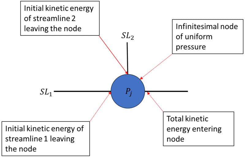

We need to be using "Unsteady -Bernoulli"1 which says in general:
$$ P_1 + \rho g z_1 + \frac{1}{2}\rho v_1^2 = \int_1^2 \rho \frac{\partial v_s}{\partial t} ds + P_2 + \rho g z_2 + \frac{1}{2}\rho v_2^2 \tag{1}$$
If we assume uniformly distributed properties, the streamlines in a particular section of the flow are straight. As a result, the partial derivative of the velocity of the flow in that section does not depend on its position, and can be taken outside the integral. Basically... this ignores the flow transition between tanks and pipes.
Apply ##(1)## between the junction and tank liquid surface in each tank. Splitting the integral at the transition we have that:
$$\begin{aligned} P_j + \frac{1}{2}\rho \left(\frac{A}{A_p}\right)^2 \dot z_1^2 &= \int_j^a \rho \frac{\partial v_s}{\partial t} ds + \int_a^1 \rho \frac{\partial v_s}{\partial t} ds + P_1(z_1) + \rho g z_1 + \frac{1}{2}\rho \dot z_1^2 \\ \quad \\ &= \rho \frac{A}{A_p} \ddot z_1 \int_j^a ds + \rho \ddot z_1 \int_a^1 ds + P_1(z_1) + \rho g z_1 + \frac{1}{2}\rho \dot z_1^2 \\ \quad \\ &= \rho \frac{A}{A_p} \ddot z_1 l + \rho \ddot z_1 z_1 + P_1(z_1) + \rho g z_1 + \frac{1}{2}\rho \dot z_1^2 \\ \quad \\ &= \rho \left( \frac{A}{A_p} l + z_1 \right)\ddot z_1 + P_1(z_1) + \rho g z_1 + \frac{1}{2}\rho \dot z_1^2 \end{aligned}$$
$$ \tag{2} $$
##l## is just an arbitrary length of pipe joining the junction to tank 1
##A_p## is the area of the branch.
Applying ##(1)## from the junction to tank 2 we get:
$$ P_j + \frac{1}{2}\rho \left(\frac{A}{A_p}\right)^2 \dot z_2^2 = \rho \left( \frac{A}{A_p} H + z_2 \right)\ddot z_2 + P_2(z_2) + \rho g \left(H+z_2\right) + \frac{1}{2}\rho \dot z_2^2 \tag{3}$$
We also have continuity at the junction:
$$ Q = A \dot z_1 + A \dot z_2 \tag{4}$$
Then assuming the pump is drawing from a very large reservoir at atmospheric pressure:
$$ P_{atm} + \rho g h_p(Q) = P_j + \frac{1}{2}\rho \frac{Q^2}{A_m^2} + \rho L \dot Q \tag{5} $$
Where ##A_m## is the area of the main feeding the system. We can use ##(5)## to eliminate ##P_j## in each of the equations.
For the pump curve we can say generally:
$$ h_p(Q) = C - \beta Q^2 $$Using what we figured out earlier, set the tanks in an initial state of equilibrium at time ##t = 0##, pick the thermodynamics for the ideal gas compression (adiabatic?). Turn on the pump, simultaneously solve ##(2)## through ##(5)## under the initial conditions:
##z_1(0) = z_{1,o}##
##z_2(0) = z_{2,o}##
##\dot z_1(0) = 0 ##
## \dot z_2(0) = 0 ##
Reference:
[1] https://ocw.mit.edu/courses/2-25-ad...edabdfd4b95c1792_MIT2_25F13_Unstea_Bernou.pdf
Likes Juanda

Hankelec said:
I am also uncertain if the electronics analogy is useful with this problem as I don't know what would represent gravity in the pump off state.
Gravitational potential is a capacitor of some variety. While the pump is on and there is flow in the system gravitational potential is accumulating. It is capable of being returned to the lower tank at later time. This is indeed what happens when the pump is switched off, unless the tanks end the cycle in equilibrium.
Anyhow the analogy is not so important at this point. I believe I have captured the necessary system of equations in #31. I doubt turning them into electrical components makes the system any easier to physically solve.
