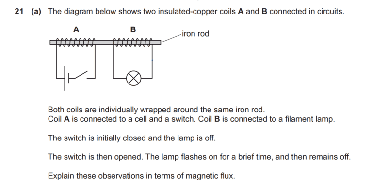

Initially the current is non-zero therefore we have a magnetic field present, and at the end there is no current therefore there is no magnetic field present.
When we open the switch, and the current drops to 0, there is a change in the magnetic flux of B, as the field from A has gone. This change is intuitively a decrease, right?
If so, why does the markscheme state that "Flux links to B", should it not be "Flux de-links from B"? Or am I being pedantic?

1) You haven't explained (in terms of magnetic flux) the first observation: why the lamp is initially off - even though the switch is closed.
2) And you haven't made the key point - that a changing flux induces an emf (or induces acurrent).

Coils A and B share the same iron core. As a result, the magnetic flux (created by the current in coil A) is linked to coil B.
If the flux through A increases, so does the flux through B.
If the flux through A decreases, so does the flux through B.
If the flux through A is constant, so is the flux through B.
Any change in the flux through B induces an emf in B.
