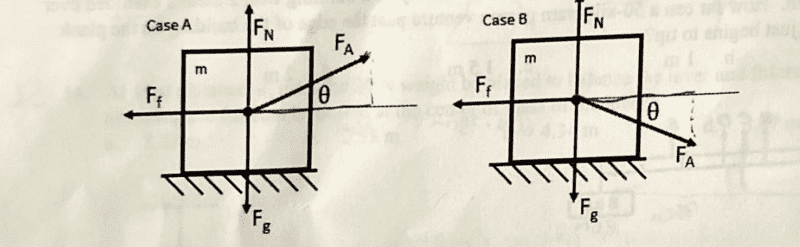

For which case would the applied force be greater?
The discussion revolves around comparing the applied force in two scenarios, A and B, where the force is applied at different angles. In case A, the applied force decreases the normal force, while in case B, it increases it, leading to different frictional forces. The participants clarify that the normal force (N) is not the same in both cases and emphasize the need for accurate equations to derive the applied forces. Ultimately, it is concluded that the applied force in case B is greater than in case A, contingent on the angle of application and the coefficient of friction. The conversation highlights the importance of careful algebraic manipulation and understanding of forces in physics problems.
paulimerci
287
47
Assuming constant velocity, for which case would the applied force be greater?
F = ma
If F is applied at an angle above the horizontal, it decreases the normal force and vice versa.
So in case A,
net force along X = F applied cos theta - friction
since the object is moving with constant velocity, a = 0 and so the above equation becomes
F applied cos theta = friction
Now along the y axis,
net force along Y = N + F applied sin theta - mg
Since the object is not moving vertically F net in the y direction is taken zero,
0 = N + F applied sin theta - mg
N = mg - F applied sin theta
Similarly for case B,
N = mg + F applied sin theta
From the equations above for normal force we can say that F applied is greater for case B than case A. Is my solution right?

Your conclusion does not follow from the premises. I am not saying it's incorrect, it just doesn't follow. I suggest that in each of the two cases you derive an expression for Fapplied and draw your conclusion based on a comparison between the two expressions. You have all the pieces, so just put them together.
Likes paulimerci and topsquark
You have the right idea in mind and right answer, but as @kuruman says above, you have not completed the logical argument to justify your conclusion (so close though!).
So the final part that is missing is to talk about how the angle of the pulling force decreases or increases the normal force of the mass on the friction plane, and how that changes N and the retarding friction force for each scenario. Can you post a final answer with all of that included?
In case you are not seeing why objections are being made, go through the algebra again being very careful only to use the same variable for forces that are necessarily the same.
For case A,
F applied = mg - N/ sin theta
For case B,
F applied = N-mg/ sin theta
To conclude: For case A, Applied force is maximum when the angle of the pulling force is minimum. Thereby when the applied force is greater, N will be smaller. Similarly for case B, the applied force is maximum only when the angle of the pulling force is minimum, in here as applied force increase N also increases. Therefore I can conclude saying case B's applied force is greater than case A.

You are still using N for two different forces.
I'm I missing something? I don't get it!
The magnitude of N changes for each case due to the direction of the vertical component of the applied force.
Making a free body diagram of each case can clarify that.

In post #1 you wrote:
"N = mg - F applied sin theta​
N = mg + F applied sin theta"
You have no reason to assume N is the same in both cases, and you know F won't be. So write ##N_A=mg-F_A##, ##N_B=mg+F_B##.
Whoops, I meant of course ##N_A=mg-F_A\sin(\theta)##, ##N_B=mg+F_B\sin(\theta)##

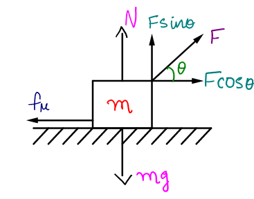

ok, so use that form (as corrected now in post #10). Use the same notation for the horizontal force balance equations, then combine them to eliminate ##N_A, N_B##.
If ##N_A, N_B## are two different forces, is it possible to eliminate them? so do you want me to substitute ##F_A=F_F## and ##F_B=F_F# for horizontal component to the applied force in the vertical component? The frictional force are different in both cases right?
Yes.
In post #1 you wrote "F applied cos theta = friction". Rewrite that as ##F_A \cos(\theta) = F_{friction,A}##, as I advised in post #16.
What equation relates ##N_A, F_{friction,A}##?
haruspex said:
Yes.
##F_{friction,A}=μ N_A##
##F_{friction,B}=μ N_B##
substituting the above equations in horizontal equations we get,
##F_A \cos(\theta)=μ N_A##
##F_B \cos(\theta)=μ N_B##
substituting the above equations in equations for vertical we get,
##F_A = μ mg/ \cos(\theta)+μ ##
## F_B = μ mg/ \cos(\theta)-μ ##

I assume you mean ##F_A = μ mg/ (\cos(\theta)+μ) ##, but that's not right either. What happened to sin(theta)?
yeah, I forgot to include that!
so what do you get now?
I got
##F_A = μ mg/ {cos\theta}+μ {sin\theta}##
##F_B = μ mg/ {cos\theta}-μ {sin\theta}##

Please use parentheses appropriately. What you posted says ##F_A = (μ mg/ {\cos(\theta}))+μ {\sin(\theta)}##, which is nonsense. I hope you mean ##F_A = μ mg/ ({\cos(\theta})+μ {\sin(\theta}))##.
Having obtained the equations which give ##F_A ## and ##F_B ## in terms of m, g, μ and θ, you are now in a position to answer the question in post #1.

It's better to use the Latex "\frac" and perhaps double dollar delimiters:
$$F_A = \frac{\mu mg}{\cos\theta +\mu \sin\theta}$$$$F_B = \frac{\mu mg}{\cos\theta -\mu \sin\theta}$$If you reply to this post you'll see the Latex I used.

Assuming x>y>0, which is larger, ##x-y## or ##x+y##?
What about ##\frac 1{x-y}## and ##\frac 1{x+y}##?

3>2, so is 1/3 >1/2 or 1/2>1/3?
  • #34
1/2>1/3
  • #35
paulimerci said:
1/2>1/3
Right, so if ##x+y>x-y## is ##\frac 1{x+y}>\frac1{x-y}## or ##\frac 1{x+y}<\frac1{x-y}##.
  • #36
1/(x+y) < 1/(x-y)
  • #37
paulimerci said:
1/(x+y) < 1/(x-y)
Right, so is FA or FB the greater?
  • #38
FB is greater
  • #39
paulimerci said:
FB is greater
Right. All clear now?
